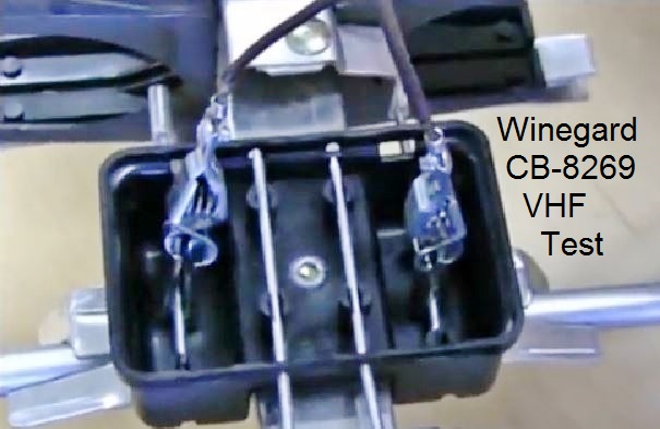

The 7698 is a popular combo antenna for both UHF and VHF-High. With the 7698 you must follow the instructions with care when you unfold the VHF elements for max gain. The 7698 has a unusual method of combining the UHF and VHF sections that I don't like, but it rarely is a problem. There are forks on the circuit board that connect to the wires from each section with pressure contact. The circuit board is in the CB-8269 housing that can be replaced.
http://forum.tvfool.com/attachment.p...1&d=1499537712
http://forum.tvfool.com/attachment.p...1&d=1499537896
http://forum.tvfool.com/attachment.p...1&d=1499538211
http://forum.tvfool.com/attachment.p...1&d=1499538454
How To Troubleshoot a Winegard Antenna Cartridge Housing
https://www.youtube.com/watch?v=TlQk...ule1MX8jCAfvPQ
