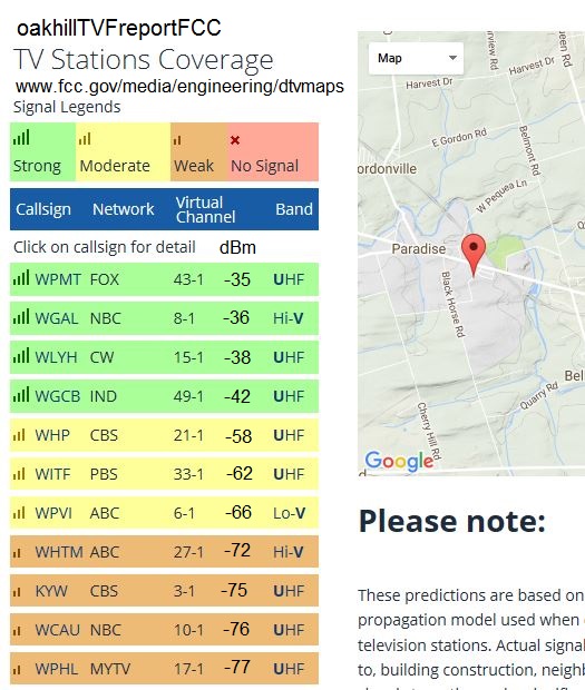

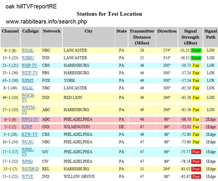

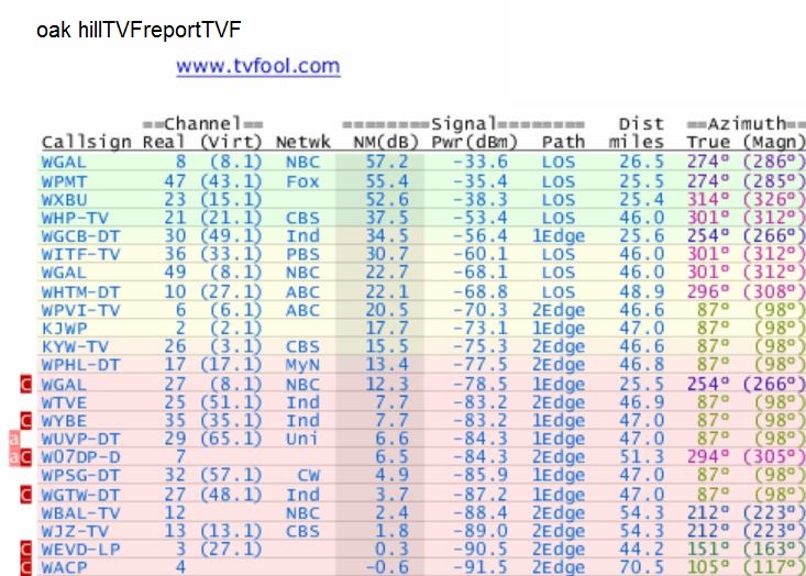

Thank you for the report; here is an extract:
this report is from rabbitears.info:
and for comparison, this report is from the FCC DTV map site; it uses 30' antenna height:

This is what is on WGAL real channel 8 and 49:
http://www.rabbitears.info/market.ph...&callsign=wgal
8.1 NBC
8.2 MeTV
Real channel 8 is a VHF-High channel. A UHF bowtie antenna doesn't work very well on VHF-High unless the signal is very strong. An attic location for an antenna and trees make TV signals weaker.
Are you using a preamp?
WPMT now on real channel 36:
http://www.rabbitears.info/market.ph...&callsign=wpmt
33.1 PBS
33.2 PBS Kids
43.1 Fox
43.2 Antenna TV
WXBU: Comet (WXBU) is moving to a new frequency on December 29, 2017 at noon.
http://local21news.com/features/comet-move/comet
see WHP on real channel 21, will move to real channel 32
http://www.rabbitears.info/market.ph...h&callsign=whp
15.1 Comet
21.1 CBS
21.2 MyN
21.3 CW
KJWP on real channel 2 which is a VHF-Low channel; very big antenna elements needed for it
http://www.rabbitears.info/market.ph...&callsign=kjwp
2.1 MeTV
2.2 Grit
2.3 Escape
2.4 Heroes & Icons
2.5 Retro TV
KYW real channel 26, moving to 30
http://www.rabbitears.info/market.ph...h&callsign=kyw
3.1 CBS
3.2 Decades

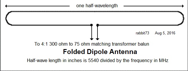

Grit is on KJWP on real VHF-Low channel 2, that is in a different direction. You could build a simple antenna for it that could be aimed at 87 degrees to see if you can pick it up. If you connect that antenna alone to your TV and you can pick it up, it could be easily combined with your bowtie antenna with a HLSJ combiner and you wouldn't need a rotator or an A/B switch.
Channel 2 is 54 to 60 MHz. The center of the channel is 57 MHz.
5540/57 = 97 inches for a halfwave dipole
If you can't find 300 ohm twin lead, you can use some 14 gauge solid copper electrical wire for a folded dipole:
If the folded dipole for channel 2 is almost, but not quite, good enough, you can add a director and a reflector to convert it into a 3 element beam:

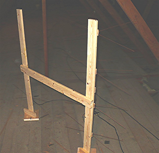

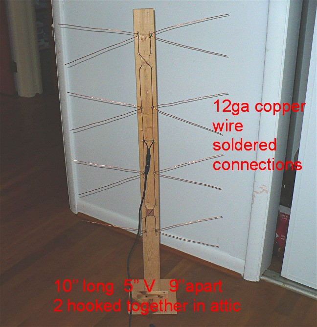

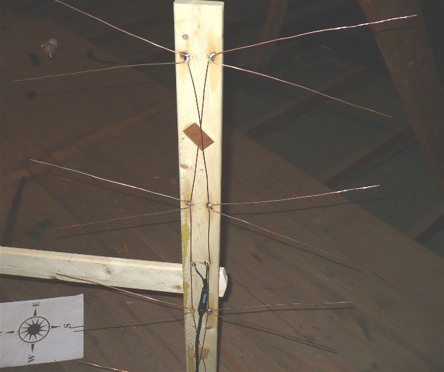

2 hooked together in attic at 280*
I have a spare I'm not using

Thank you for the photos.

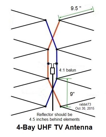

The dimensions are pretty close to correct, but when you fasten the wires to wood without any insulators there will be some signal loss. Also, a reflector on just one antenna would give at least as much gain as two antennas without reflectors.

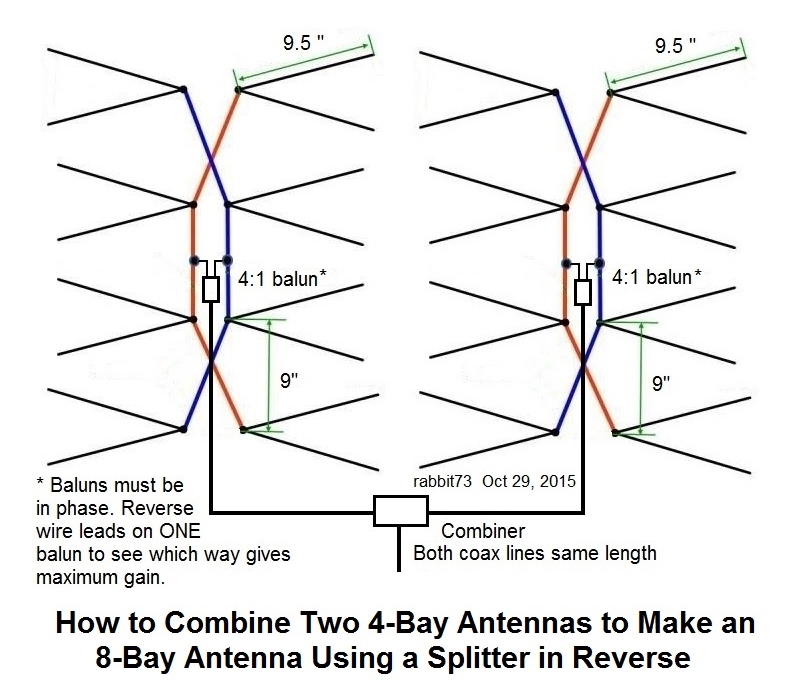

How did you combine the two antennas, a splitter in reverse?
When you combine two antennas that have wire baluns, the is a 50% percent chance of getting it right, because the two antennas must be connected in phase to have any gain over just one.

''How did you combine the two antennas, a splitter in reverse?''
Yes

Did you make the two coax lines exactly the same length?
Did you try reversing the leads on just one balun to see which way gives the most gain? When the baluns are not connected in phase the main lobe of the combined antennas splits in two:

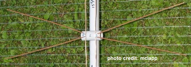

No, that would not get Grit on channel 2. Leave the bowtie antennas aimed at 280° and use a separate antenna for 87°.
Antenna elements must be a certain length for each channel frequency for best results. It's like organ pipes; short pipes are for the high frequency notes and the pipes are long for the low frequency notes.

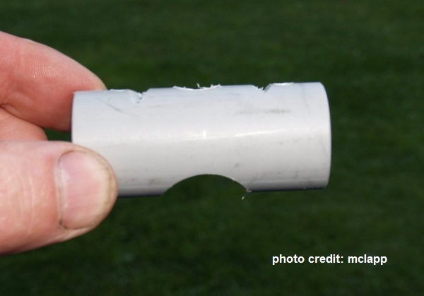

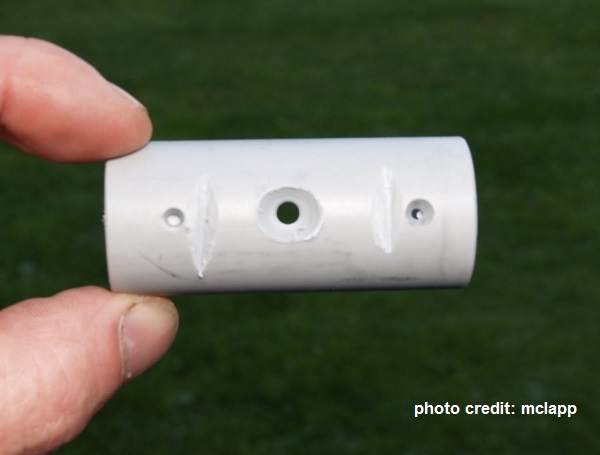

Can I use small pieces of wood as insulators?
No, that wouldn't be any better; it should be plastic like a PVC coupling:
http://m4antenna.eastmasonvilleweather.com/index.html
http://m4antenna.eastmasonvilleweath...0Drawings.html
https://sites.google.com/site/maycre...setup/mclapp-4

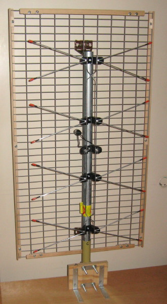

Is the reflector the same height and width as the antenna?
Angelo

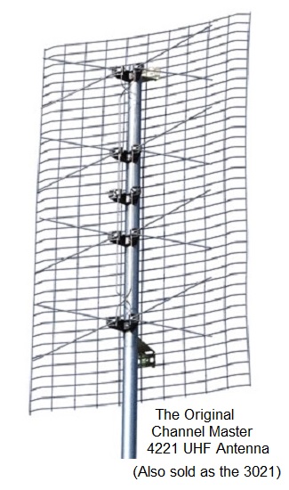

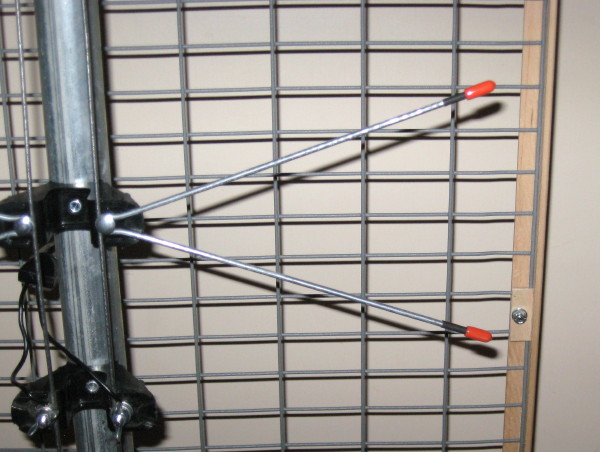

A little bigger, like this:
I modified one for a friend to make it safer to handle in his attic. I put wood molding corner strips on the edges of the 1" x 2" wire mesh reflector:
and black heat shrink tubing and thread protector caps on the ends of the whisker elements to keep from getting scratched:
