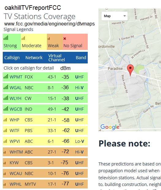

oak hill 13-Jan-2018 4:29 PM
Here's a link to my report
http://www.tvfool.com/?option=com_wr...60ed71b2ba5770
And yes, stations come and go and show up at different channels. Or disappear altogether.
Angelo
rabbit73 13-Jan-2018 8:20 PM
3 Attachment(s)
Thank you for the report; here is an extract:
http://forum.tvfool.com/attachment.p...0&d=1515874840
this report is from rabbitears.info:
http://forum.tvfool.com/attachment.p...1&d=1515875021
and for comparison, this report is from the FCC DTV map site; it uses 30' antenna height:
http://forum.tvfool.com/attachment.p...1&d=1515875145

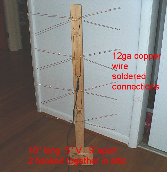

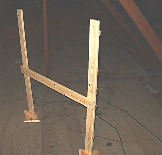

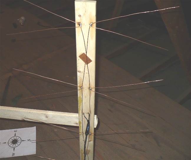

oak hill 14-Jan-2018 8:07 PM
3 Attachment(s)
2 hooked together in attic at 280*
I have a spare I'm not using
Attachment 3038
Attachment 3039
Attachment 3040
rabbit73 14-Jan-2018 11:53 PM
2 Attachment(s)
Thank you for the photos.
The dimensions are pretty close to correct, but when you fasten the wires to wood without any insulators there will be some signal loss. Also, a reflector on just one antenna would give at least as much gain as two antennas without reflectors.
http://forum.tvfool.com/attachment.p...2&d=1515973532
How did you combine the two antennas, a splitter in reverse?
When you combine two antennas that have wire baluns, the is a 50% percent chance of getting it right, because the two antennas must be connected in phase to have any gain over just one.
http://forum.tvfool.com/attachment.p...3&d=1515973999
