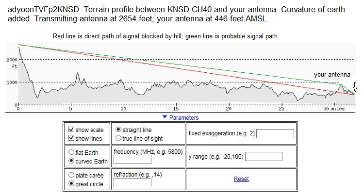

If I buy a outdoor antenna, can i at least get the channels on the red?
You have a good chance of getting the red ones down to KNSD if there is nothing in the signal path to block them.

Old 13-Jul-2017, 12:33 PM   #20
You are behind a hill for KNSD:
