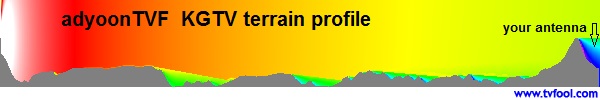

Has your installer given you a guarantee of good reception, or is he just going to put the antenna where he wants it without any consideration of reliable reception?
You need two antennas, a VHF antenna for KFMB and KGTV at 175 degrees magnetic, and one for UHF for KSWB, KPBS, and KNSD at 138 degrees magnetic.
If you want to go cheap, the MCM 30-2476 for VHF, the Solid Signal HDB91X for UHF, and the RCA TVPRAMP1R preamp.
I suggested the Antennas Direct DB8E because it has more gain at the low end of UHF than the 91XG or HDB91X where channels will be moving after repack. KNSD will be moving to channel 17 in a few years; you could buy another antenna then if necessary.

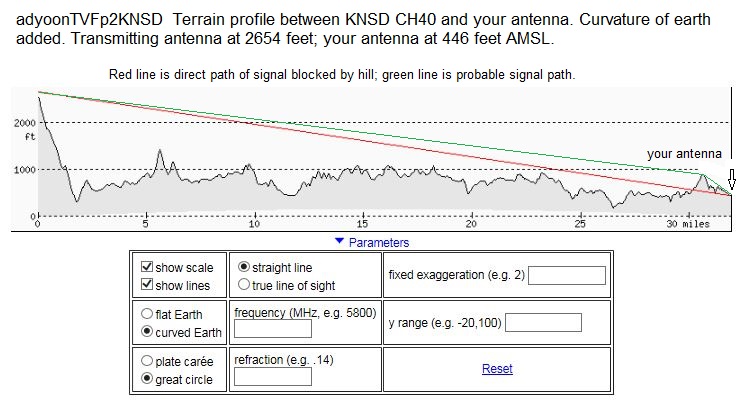

http://forum.tvfool.com/attachment.p...1&d=1489973660
If I buy a outdoor antenna, can i at least get the channels on the red?
You have a good chance of getting the red ones down to KNSD if there is nothing in the signal path to block them.

My comments on Antenna Ranking by FabatHome
1 Attachment(s)
The 10 Best Outdoor Antennas of 2017
http://www.fabathome.org/best-outdoor-antenna/

http://forum.tvfool.com/attachment.p...1&d=1499942971
The tendency these days is for most, but not all, antenna manufacturers to find a way to make it cheaper, not better.

rabbit73 13-Jul-2017 12:33 PM
1 Attachment(s)
You are behind a hill for KNSD:
http://forum.tvfool.com/attachment.p...1&d=1499945498
