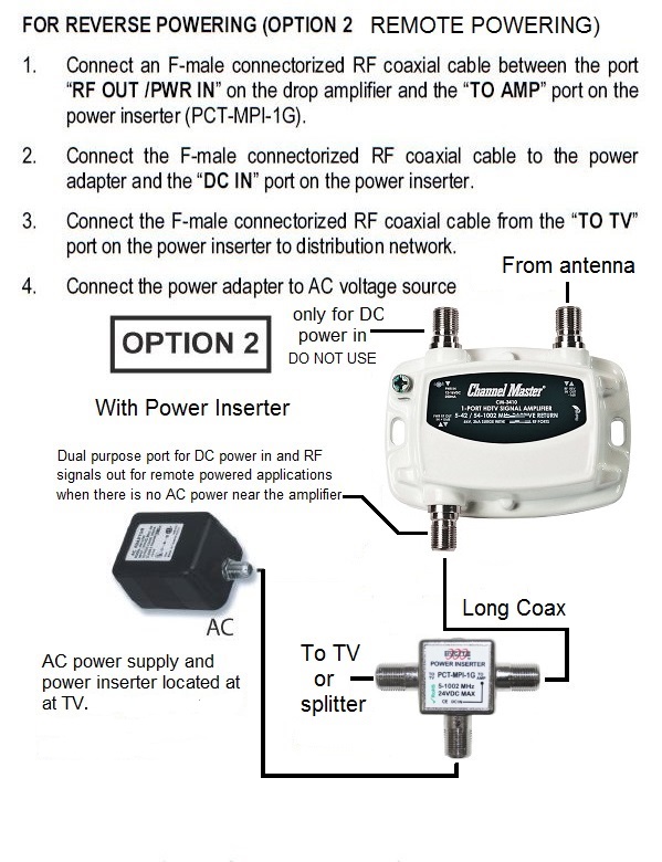

Code:
             20' > TV
C2 > 5' > SPLITTER #1              50' > TV
              CM3410 > 50' > SPLITTER #2
                |                  |       20' > TV
              POWER                |      /
                                   SPLITTER #3
                                           20' > TV
All splitters are 2-WAY
IF AC POWER IS NOT AVAILABLE AT THE 3410, ADD A PCT-MPI-1G
POWER INSERTER AT THE BOTTOM OF THE FIRST 50' COAX JUST
BEFORE THE SECOND SPLITTER.
If you have AC power at the first splitter, the DC power for the Channel Master 3410 goes in the upper left port. If you do not have AC power at the first splitter, then you must provide remote DC power for the 3410 through the first 50' run using a power inserter just before the second splitter.
I am suggesting the 3410 and 2-way splitters instead of the 3414 so that you can send more signal to the longer runs for better balance.

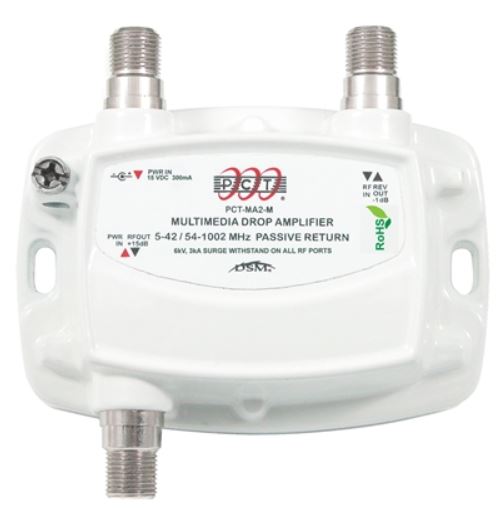

The PCT-MA2-M is the same as the CM3410.

I see PCT also makes a product like the 3410.
Same amp, different label.
Old 18-Dec-2016, 11:45 AM   #9
Thanks. I see PCT also makes a product like the 3410. Would that be ok?
Yes, if it is this one:
Which PCT model are you talking about? PCT bought out Channel Master, so it is the same company, but they make several different models that are similar.

If power is not available at the 3410, use a power inserter at the bottom of the first 50' coax just before splitter #2:
Code:
             20' > tv
            \          PCT-MPI-1G          /
          CM3410 > 50' > POWER > SPLITTER #2
                        INSERTER      |       20' > TV
                                   SPLITTER #3
                                              20' > TV
ALL SPLITTERS ARE 2-WAY

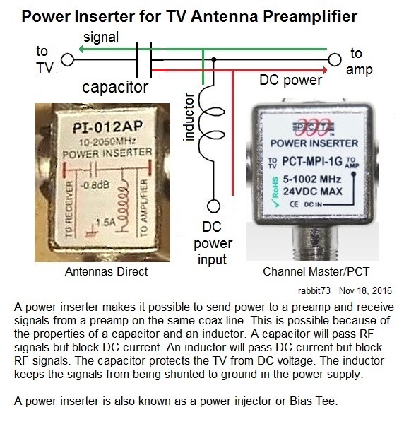

the 3410 at the beginning because you sent me a diagram showing it at the end of the long run
I NEVER showed the 3410 at the end of a long run; always just after the first splitter. I DID show the power inserter at the end of a long run where you might have power, but not the 3410 amp.
The idea is to put an amp as close as possible to the antenna to amplify the signals BEFORE they suffer the coax loss.
You do not need to do electrical wiring if you don't have AC power at the 3410. If you have power at the bottom of the 50' coax, put the PCT-MPI-1G power inserter there. That's where you wanted to put the 3410, so you must have power there.
The power inserter will send power up to the 3410 on the SAME 50' coax that sends the signals down. That is the purpose of the power inserter, so that you don't need to have power at the 3410.
The power up shares the same coax with the signals down.
A power inserter for a preamp works the same way.
It is complicated, and it took me a while before I understood it.
OK?
