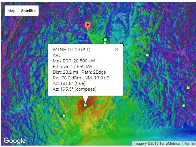

You are on the fringe of coverage for WTNH:
your location is between the blue and weaker purple signal strength:

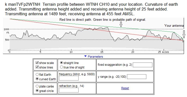

This is the WTNH terrain profile shown by tvfool:
http://www.tvfool.com/?option=com_wr...ALLTV%26n%3d12
This is the terrain profile using different software:

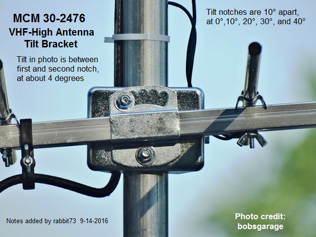

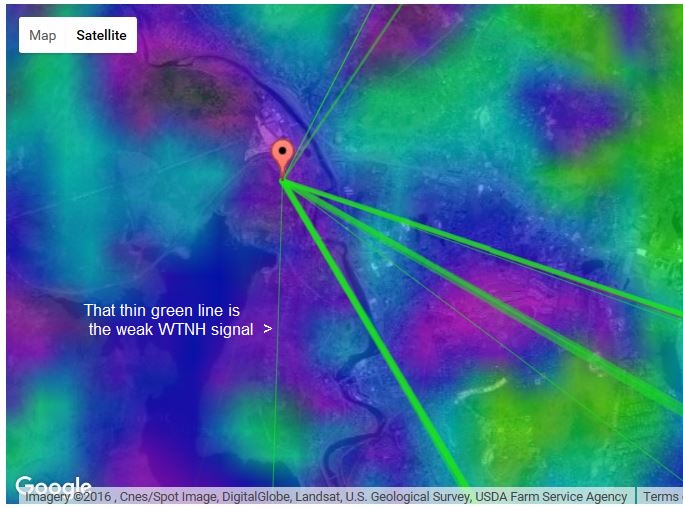

This what the 30-2476 looks like up in the air:
I suggest you tilt the front of the antenna up to catch the signal coming from the mountain ridge; try 15 degrees.

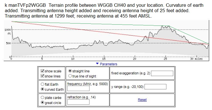

The terrain profile for WBBG is also difficult.
http://www.tvfool.com/?option=com_wr...ALLTV%26n%3d11
If you want to try it, I suggest an Antennas Direct 91XG or an HDB91X UHF antenna, also tilted up. This will be completely separate from your other UHF antenna, and aimed at 41 degrees magnetic.

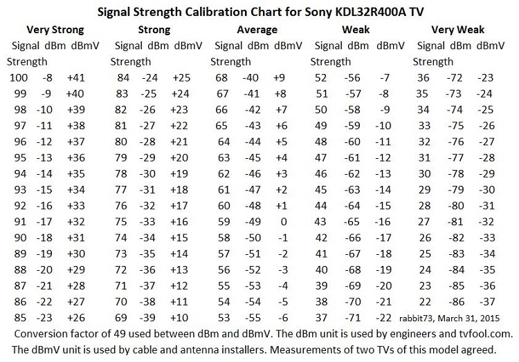

what signal measurements (from abc) are minimal requirements for reliable signal?
Most installers make measurements in dBmV. WGGB is listed as about -75 dBm which about -26 dBmV. That is too weak; my Sadelco DisplayMax800 signal level meter doesn't even read much below -20 dBmV for a single channel scan, but my Sadelco 719E will read lower.
I would like to see at least -10 dBmV coming out of the antenna for ABC, because OTA signals constantly vary in strength, especially 2Edge signals that are affected by atmospheric changes more than LOS signals.
You can add the antenna gain to the dBm signal power listed on the report. You can also add preamp gain, but a preamp can't be used for the strong signals because it will be overloaded and the tuner will also be overloaded.
Most tuners will drop out a signal below -85 dBm = -36 dBmV.
Here is a calibration chart I made for my Sony KDL32R400A that gives signal strength readings at the tuner. It will give you an idea of the relationship between dBm and dBmV:

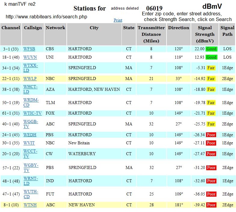

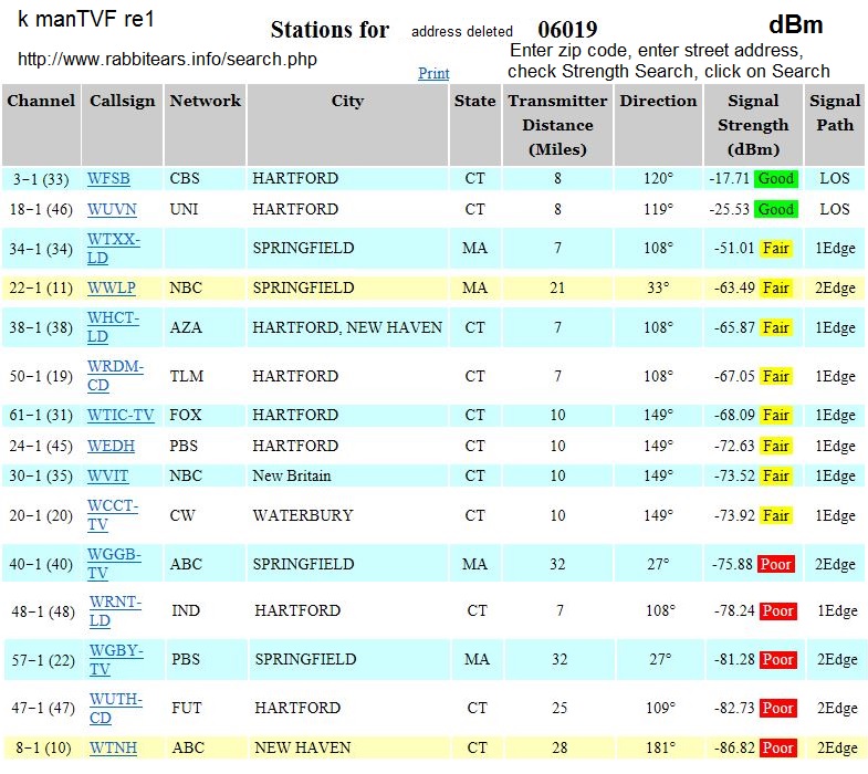

Old 24-Sep-2016, 7:37 PM   #17
Originally Posted by k man View Post
I just found another site that maps ota broadcasts. wtnh and wggb are not even listed as an option.
It is possible to generate a report similar to the tvfool report at rabbitears.info. This report gives signal power in dBm:
signal power in dBmV:

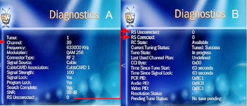

2. the other night during some mist/rain, channel 61 became pixelated?
Since it is coming in the back of the antenna it would be one of your problem channels. The best reception is when an antenna is aimed directly at the transmitter. The diagnostics screen can help you with the minimum values for signal strength, SNR needs to be at least 16 dB, and uncorrected errors should be zero.
3. would putting a small amp right in front of the tivo help?
Maybe yes, maybe no; you would have to try it because you don't have a way to measure signal strength except with the TiVo. Maybe this one will help:
one output
http://www.channelmaster.com/Antenna..._p/cm-3410.htm
2-way
http://www.channelmaster.com/Antenna..._p/cm-3412.htm
4-way
http://www.channelmaster.com/Antenna..._p/cm-3414.htm
Your antenna already has a 20 dB preamp, but your antenna is aimed away from the strongest signals, which reduces the chance of overload.
http://www.skywalker.com/Products/Di..._DIGI2002.aspx
http://digitenna.com/files/DigiTenna%20DT-XF.pdf

Sorry, but this installer doesn't seem to get the concept of deep fringe reception. WTNH is a Hartford Market Station, and it should have been your first choice. Springfield is a much smaller market than Hartford, and won't offer you any Conn. News. The antenna that he brought to you has almost no VHF gain and was completely unsuitable for your installation. I also deem it unsuitable to attempt to pick up a strong station from the back of an antenna, as it risks the multipath problems that you experienced with WTIC.
You do not need a deep-fringe UHF antenna aimed at Springfield; you need a small UHF antenna aimed at the Farmington towers, and a large VHF yagi aimed at WTNH's transmitter in New Haven. If you like, because I am pretty close to you, I would be happy to design an antenna system for you, and have your installer put it up.
I don't climb ladders any longer because of diabetic neuropathy, but I can still provide good advice.
