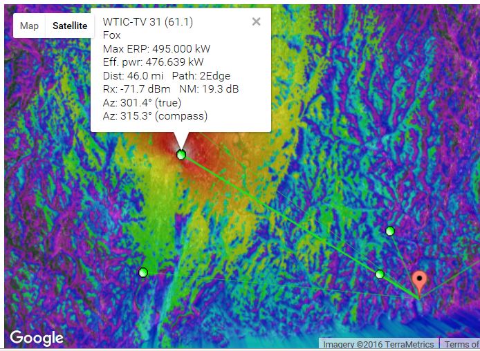

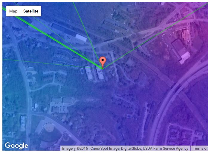

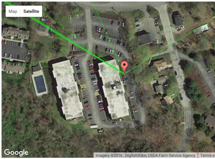

Using the coordinates from your Google map, it looks like the WTIC signal will have to go through your building to get to your antenna, unless you have a north facing window.
I thought you might have a chance for ABC, until I did a report using the Google map coordinates:
http://www.tvfool.com/?option=com_wr...e2cba340503809

You are on the fringe for WTIC coverage:
BUT being on a hill helps
