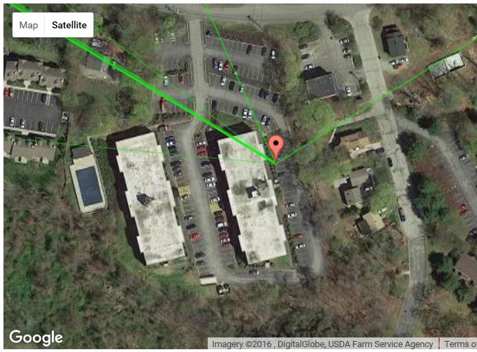

1 Attachment(s)
Using the coordinates from your Google map, it looks like the WTIC signal will have to go through your building to get to your antenna, unless you have a north facing window.
http://forum.tvfool.com/attachment.p...1&d=1475542278

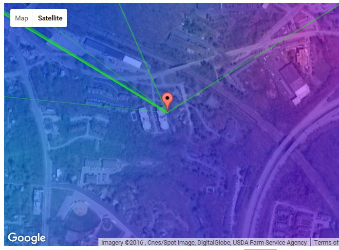

2 Attachment(s)
You are on the fringe for WTIC coverage:
http://forum.tvfool.com/attachment.p...1&d=1475543973
BUT being on a hill helps
