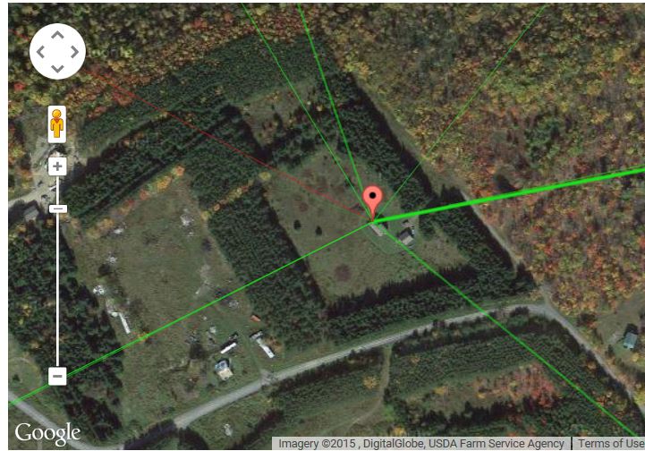

The antenna will not be on the same side of the house, I should have been more clear about that.
As for the preamp suggested. Can that be put in the basement or does it have to mounted to the mast with the antenna?
I have coax run in the house where I want my TV's and they all come together in the basement. Should I use the channel Master CM3414 4-Port Distribution Amplifier for Cable and Antenna Signal with it as a splitter or should I get an unamplified splitter.
The image you posted was close. My house is actually the one hidde by the (+) sign in the top left of the image.
Thanks again

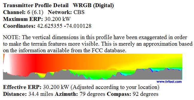

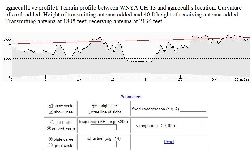

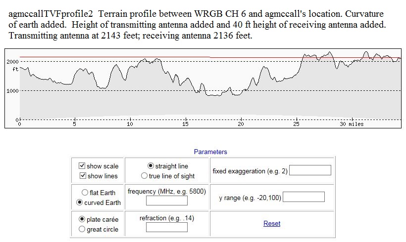

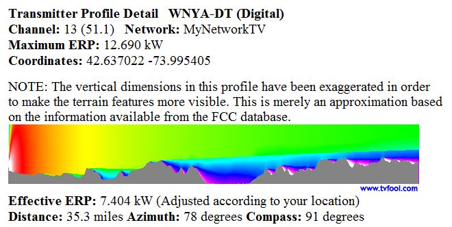

Besides the interference from the trees, you also have terrain interference for the signals on their way to your location:
Your weakest signal (the transmitter is at the left end; your location at the right):
Your strongest signal:
VHF signals can make it over the peaks better than UHF signals, by refraction.

The image you posted was close. My house is actually the one hidden by the (+) sign in the top left of the image.
Thanks for telling me; I rarely get to find out how close my guess was because this site tries to protect the identity of users.
