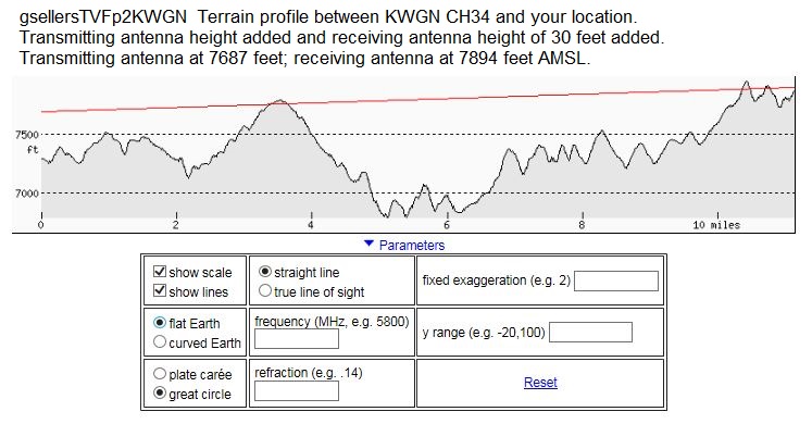

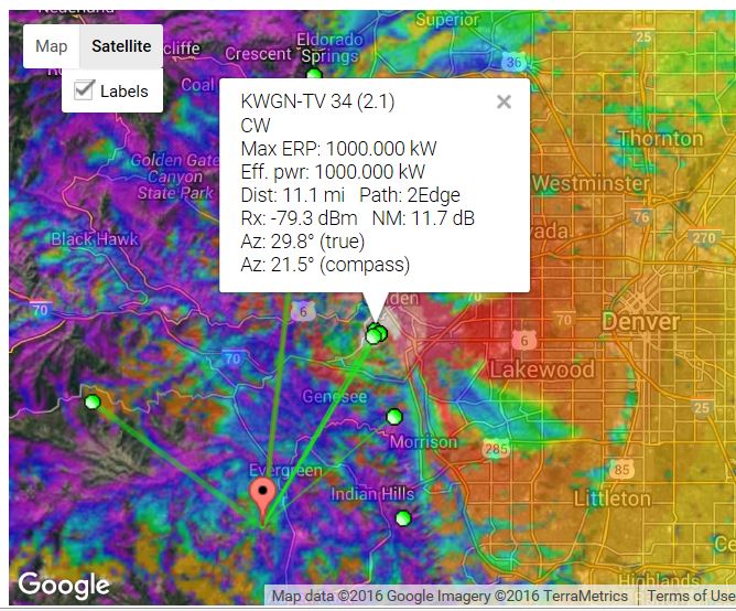

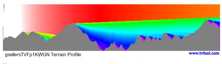

The terrain between the local transmitters and your location is very difficult for the signals.
If you click on a callsign in your report you can see the terrain profile. The transmitter is on the left and your location is on the right.
the channels I want: Channels 2, 4, 7 and 9, 31 - the major networks
2, KWGN CW, virtual channel 2.1, real channel 34. NM 6.1 dB
http://www.tvfool.com/?option=com_wr...dALLTV%26n%3d7
Here is the terrain profile using different software:

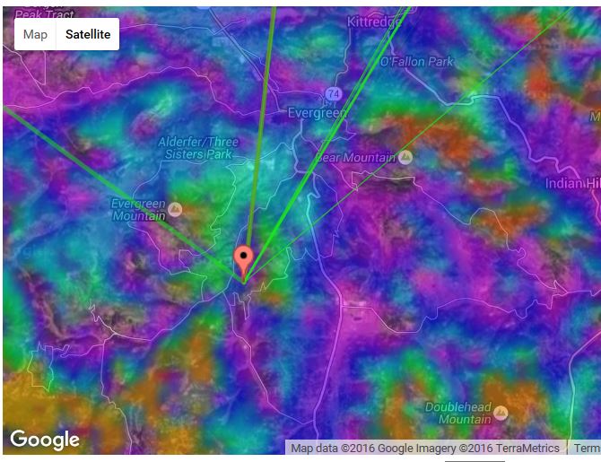

The signal coverage is very spotty because of the rough terrain:
closeup:
