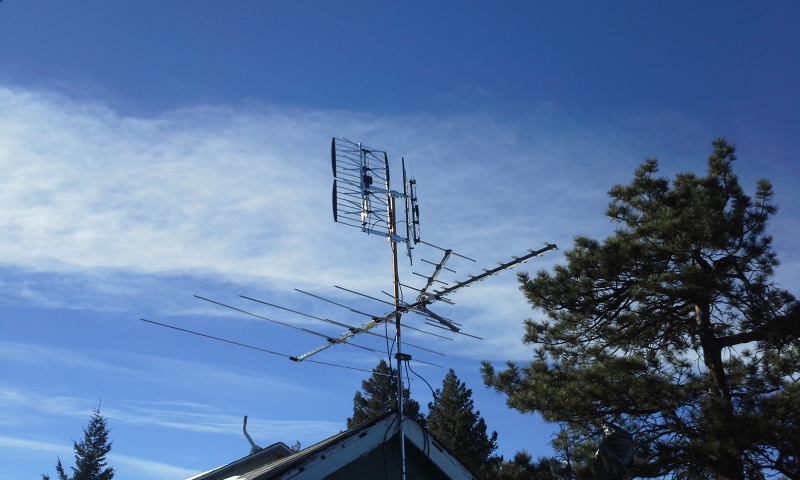

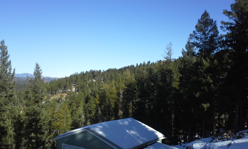

Here's a pic of my view to the tower
http://forum.tvfool.com/attachment.p...1&d=1451776804
And the antennas
Thanks!

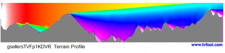

The terrain between the local transmitters and your location is very difficult for the signals.
If you click on a callsign in your report you can see the terrain profile. The transmitter is on the left and your location is on the right.
the channels I want: Channels 2, 4, 7 and 9, 31 - the major networks
2, KWGN CW, virtual channel 2.1, real channel 34. NM 6.1 dB
http://www.tvfool.com/?option=com_wr...dALLTV%26n%3d7
http://forum.tvfool.com/attachment.p...7&d=1468250817
Here is the terrain profile using different software:
http://forum.tvfool.com/attachment.p...8&d=1468267671
The signal coverage is very spotty because of the rough terrain:
http://forum.tvfool.com/attachment.p...9&d=1468268765
closeup:
http://forum.tvfool.com/attachment.p...0&d=1468281258

4, KCNC CBS, virtual channel 4.1, real channel 35, NM 5.9 dB
http://www.tvfool.com/?option=com_wr...dALLTV%26n%3d8
7, KMGH ABC, virtual channel 7.1, real channel 7, NM 21.9 dB
http://www.tvfool.com/?option=com_wr...dALLTV%26n%3d4
9, KUSA NBC, virtual channel 9.1, real channel 9, NM 19.1 dB
http://www.tvfool.com/?option=com_wr...dALLTV%26n%3d5
31, KDVR Fox, virtual channel 31.1, real channel 32, NM -6.6 dB
Notice that only 58 of 1000 kW ERP is sent in your direction because of the transmitting antenna pattern
http://www.tvfool.com/?option=com_wr...ALLTV%26n%3d12
http://forum.tvfool.com/attachment.p...&d=14682849209
I doubt that another preamp will improve your reception, unless the RCA preamp is defective.
