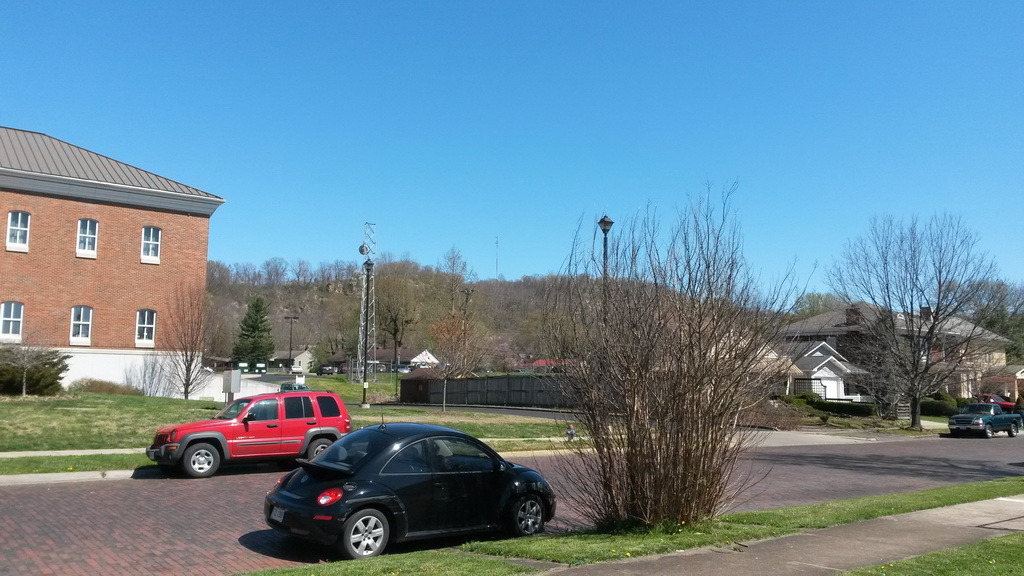

I didn't know WOUL was that close! I think the tower in the distance is theirs. That means it's directly in line with all of the TV stations we want. I guess we are all supposed to support our poor starving (Time Warner) cable company.
I'll try the HLSJ and try to find a ground. The power lines are on the opposite corner of the house but there might be a copper water pipe. The FM stations would also explain why I can't use an amplifier at all. The Radio Shack amp even has an FM trap but that doesn't work. That same amp helped with rabbit ears.

Before I forget, thanks for the photo; it helped a lot.
I think you have a good chance of getting WOWK with your antenna, if you use an FM filter and ground the coax.

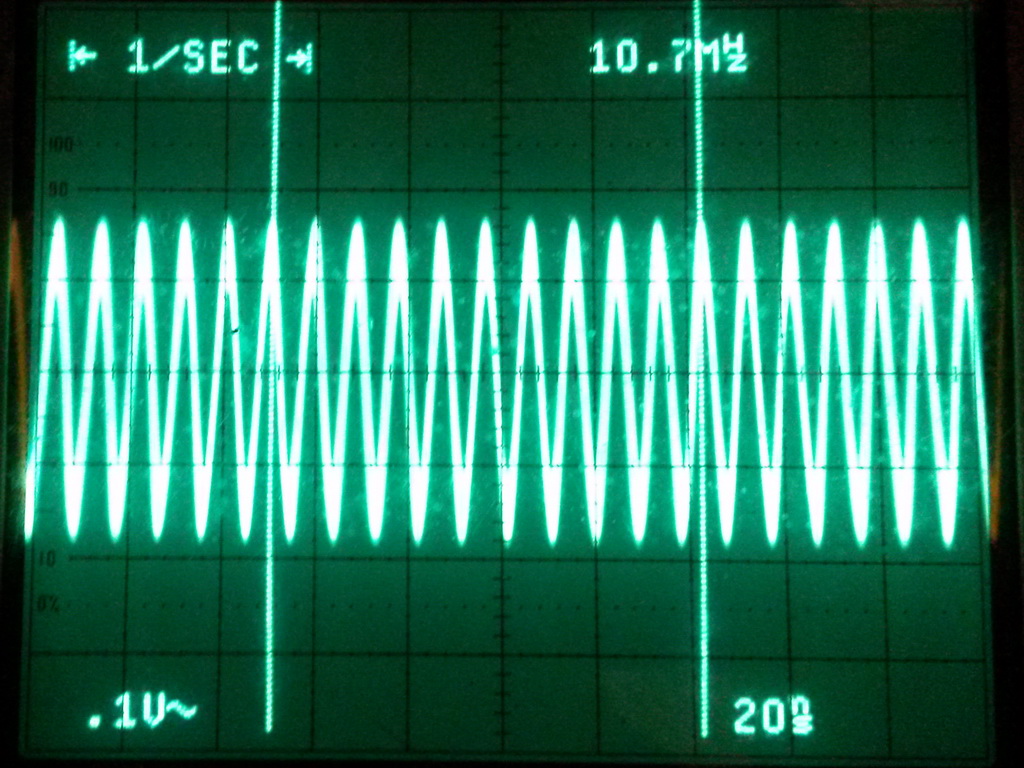

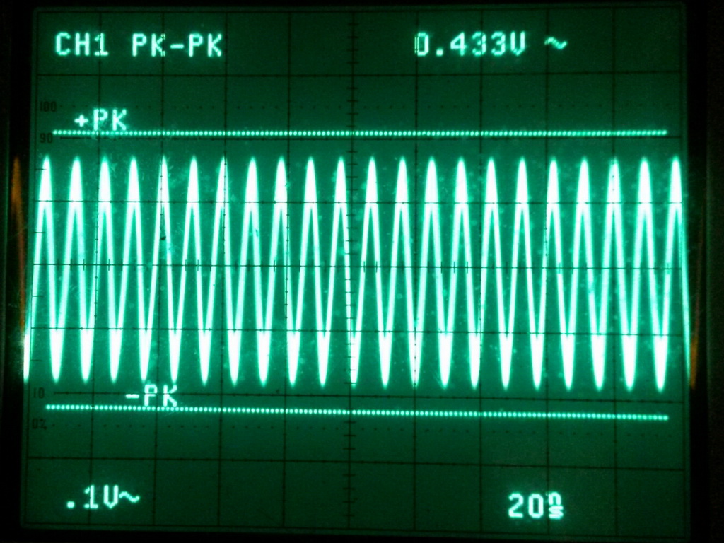

I was thinking earlier that I wish I had a Spectrum Analyzer. Then I wondered if anything would show up on an oscilloscope. It did and this should not be happening. That's 10 cycles marked so it's really showing 107MHz. But look at the voltage. That is straight off the coax.

0.433Vpp = 0.153Vrms = 153mVrms
That is a lot of RF voltage coming from your antenna!
Or as Mr. Spock would say, "Fascinating!"
Thanks for making the test; good detective work. I also wish you had a spectrum analyzer, to confirm the frequency and check for other possible interference like cell phone transmitters from above TV CH 51.
That is waaaaay too much. It does look like it is coming from WLRX, but why not from WOUL-FM that is 15 dB stronger at +4dBm; they are both in about the same direction? Maybe it has something to do with the gain curve of your antenna. The specs say FM band gain -0.8 dB.
So, 153mVrms = -5.1 dBm in a 75 ohm system; about what you would expect after looking at your FM signal report:

There are some tests you can do with your 'scope now. Insert a HLSJ, high and common ports, in the coax and take more voltage readings. Try it with and without grounding the coax. You can also try inserting a UVSJ (not the MCM UVSJ), high and common ports, which will limit reception to UHF. You should get a reading from WKAS.
WKAS -27.5 dBm + ant gain 5 dB = -22.5 dBm = 0.02 Vrms across 75 ohms = 20mVrms = 56.6 mVpp if your 'scope reads that low at 545 MHz.
