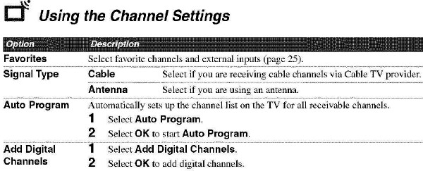

Not sure which ones are capable of manually entering channels, but another option, is to have one that allows you to :"Add Digital Channels", after the initial scan, is done.

My Sony KDL32BX320 and KDL32R400A will do what you want, in the "add a channel after scan" way that Stereocraig said, and they have a Diagnostics Screen that gives signal strength, SNR, and errors.

Thanks, I'll look for systems that allow 'Add digital channels' in the menu.
