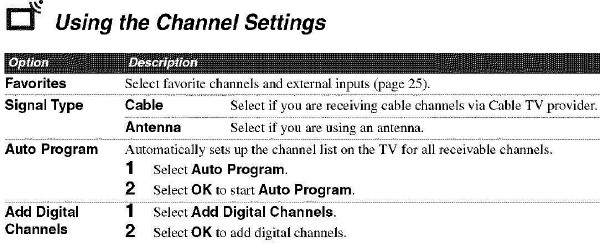

My Sony KDL32BX320 and KDL32R400A will do what you want, in the "add a channel after scan" way that Stereocraig said, and they have a Diagnostics Screen that gives signal strength, SNR, and errors.
http://forum.tvfool.com/attachment.p...1&d=1437578400
