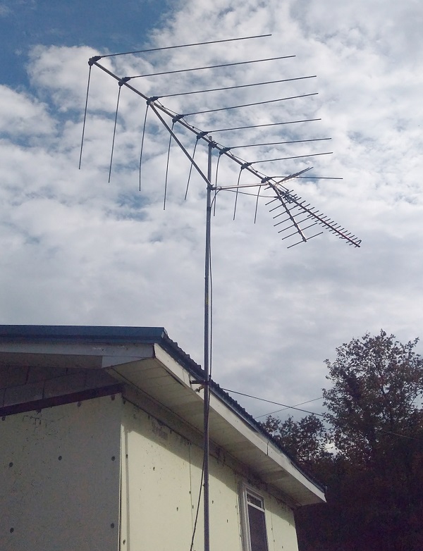

Can you tell us more about your current "25+ year old" analog antenna, and where is it aimed? What model is it, mounting height, field of view (any trees?) etc.
BTW, there is no such thing as an "analog" or "digitial" or "HDTV-ready" antenna. That is all marketing mumbo-jumbo.
I think you will be surprised at what you pull in when you mount some real horsepower up there like the HD8200U or the CM-3020 or 5020.

I'll see if I can get a picture of the present antenna.
I just assumed there was analog and digital antennas.
The height is about 20'.
There are no obstructions.
Trees, buildings or hills.
There is one tree @ 50' north that has no affect,.
I can't tell you what model it is.
I'm senile and I bought it 25 years ago, m/l.
I want to think it's a Channel Master and it was one with higher mileage ratings.
It was a VHF and the UHF was an add on.
My elevation is pretty high.
I'm on the second highest place in Armstrong County.
I couldn't find my compass which was unreliable.
North would move 45 degrees.
Just ordered anew, better one.
But, I'm somewhere between 210-235.
I realize that's a big window.
(I have a picture but don't know how to add it)

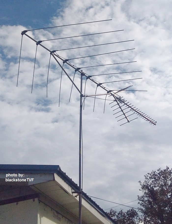

This antenna always got a lot of stations.
Just not all the time.
For example, last night, with clear skies, I was losing signal to some of the stations.
I did a scan.
Didn't get those stations but picked up (briefly) Columbus, OH which has to be close to 200 air miles and a Youngstown station I only get infrequently.
blackstone is offline   Reply With Quote

Originally Posted by blackstone View Post
That didn't work for the pic
I got the first one to work, but not the second one.
You can click on the photo in your album for a share link like this one:
https://photos.google.com/share/AF1Q...xKMTY3RlRkVl93
You can also upload the photo as an attachment for your post, using Go Advanced, but it has to be smaller than 1024 x 1024. Your image is 1836 x 3264 pixels, so I edited it, gave you a credit line, uploaded it as an attachment, and then added it as an image to my post.
This smaller image shows more of the tree in front of the antenna;

That looks like a metal roof in your picture. I wonder if that affects reception. More height, which will get your farther away from the roof, probably can't hurt. My concern has to do with the age of the antenna, but more importantly the coax. I've heard that the coax performance can degrade over time, especially at connections. I would try switching to a high-quality RG-6 (you prabably have RG-59), and use new connections, perhaps before even trying a new antenna. When you do this, take some signal readings at the bottom of the down-lead first, then change the coax and re-do the readings to see if there is an improvement.
I don't know if antenna performance itself degrades over time (e.g. 25 years). I'd be interested to hear what other folks have to say about that.

That tree is at least 200' (or more) away.
Hadn't thought about the metal roof.
Can't remember if we cut the cord before or after we put the roof on

When we put the new mast up a couple years ago, I noticed some oxidation on the connections.
Tried to clean them some but, maybe, not as good as it could have been.
I think I put new coax up at that time.
It's probably only a couple years old.
Raising the antenna at it's present location may give me challenges supporting it.
I had considered moving it to the peal of the house which is 20' to the left in the picture.
I would be able to gain another 5' or more and better support the mast and be higher than any part of the house.

I'm guessing weather is a factor, too.
For example, if it's rainy, I lose a lot of stations.
That is a classic symptom of trees in the signal path.
What direction is the antenna aimed in the photo?

Guessing without a compass.
215-240.
New compass coming tomorrow or Friday that may be able to find north.
The last one varied by 30- degrees.
There are trees.
But, at least 100 yards away in that direction.
Or more.
I am slightly below the crest of a wooded hill, maybe 1/8th mile in the direction the antenna is pointing
Except for one tree across my driveway 50' almost north of the antenna, I am pretty clear for a ways around my house.
There are trees within 100" south and east.
Hope this is helpful info.
