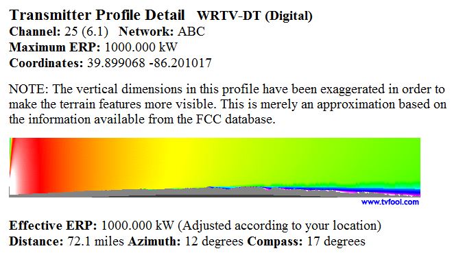

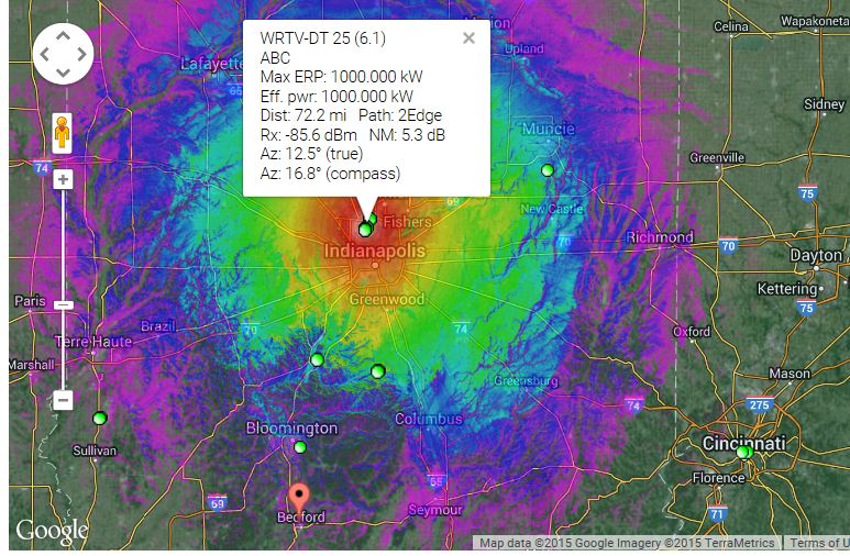

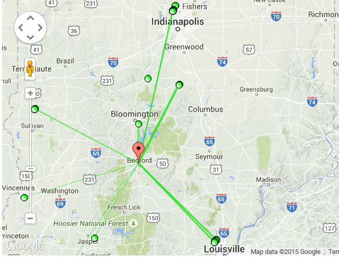

Here is the map:
If you click on a callsign in your tvfool report you will see the profile. The transmitter is at the left end and your location is at the right.
The black arc that you see at the bottom of the image is the curvature of the earth, which starts to interfere with the signal at about 70 miles.
The color code for the image is here:
http://www.tvfool.com/index.php?opti...id=15&Itemid=1
In very rough terms, the colors can be broken down as follows (not related to Antennaweb):
- White is extremely strong. Beware of signal overload on amps.
- Red-yellow-green are all quite strong. You can expect reasonable coverage with an indoor antenna.
- Cyan is where it's advisable to move the antenna up to the second floor or attic.
- Blue is where it's probably necessary to install a good antenna on the roof.
- Purple is quite weak and you really have to work at it for any chance of reception.
Here is the coverage map for WRTV ABC. You can see that the signal is pretty weak by the time it gets to your location. The color code is the same.

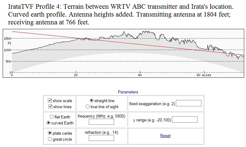

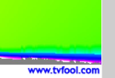

Here is a close-up of the tvfool profile at your location that shows the colors better:

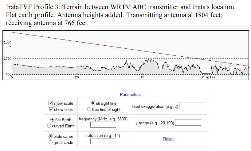

Another way to demonstrate the Indianapolis problem is to use elevation profiles:
adding the antenna heights:
but the earth isn't flat:

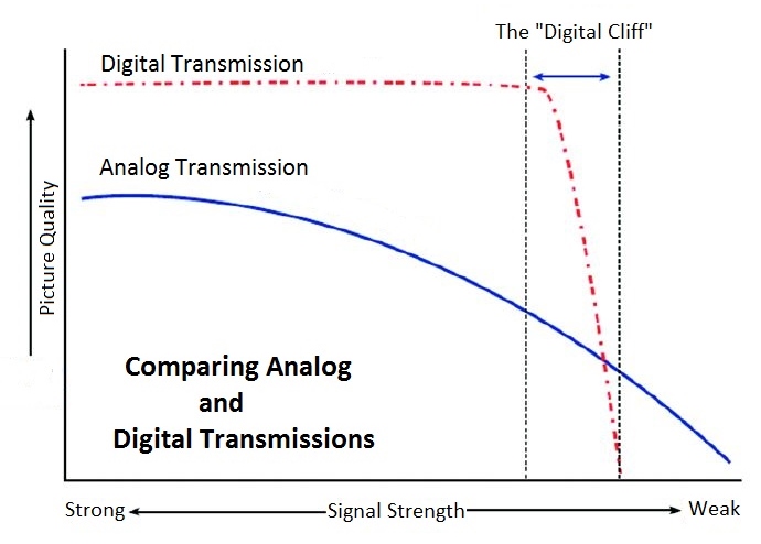

The Indy channels were analog then. You could watch them when they were very weak if you could tolerate a little snow. With digital signals it's all or nothing because of the "Digital Cliff," as ADTech mentioned.
Where do I find these terrain charts?
The ones in color are ready made on the tvfool report. The black and white ones I created using this web site; it takes a little time to learn how to use their software.

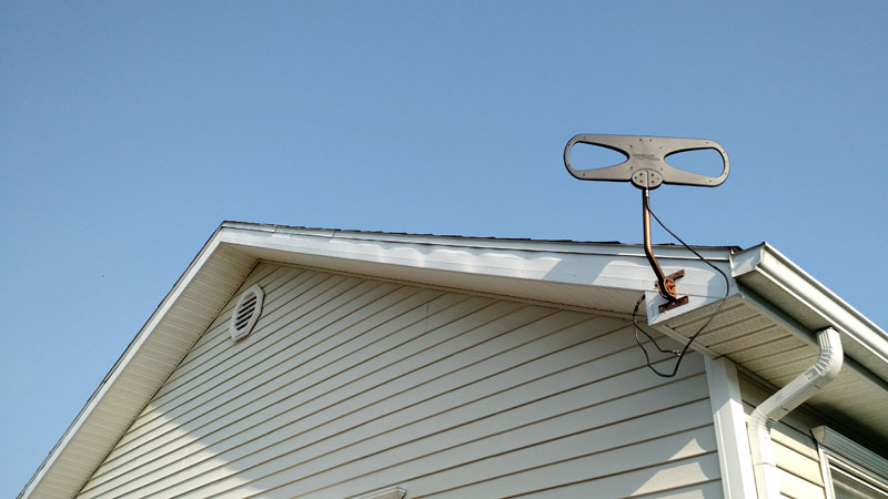

This is where I had my Amazon antenna. My plan today was to move it to the top of the house:
This is what the SE facing part of the antenna perspective:
By the time we got everything in order it ended up being the afternoon. Unfortunately it was stupid hot today and the roof temp was ridiculous. So back to Lowe's for some conduit. We were able to approximate the height of the antenna on it's normal mount. (sorry bad picture) It's not done properly I know, this is completely temporary setup for testing purposes.
When we set it we put the flat sides directly N/S instead of NW/SE. I also added a preamp I found at Menards and removed the Amazon amp. This afternoon the weather was completely clear. Doing a check with the Tivo I still got all the Louisville except one AND the displayed signal strength went from 55-60 to 70 or above. I was able to add WTTV from Indy but none of the other channels came in then. They fluctuated up and down with no stable signal.
As of 10:19 tonight, WRTV, WTHR, WFYI, WNDY, WTTK, WHMB, and WXIN from Indy all coming in solid.
My plan is still to move it to the top of the but if I put the original short J pole on there will the roof affect reception from the north?

What preamp did you get? Is it near the antenna or down at the lower end of the coax?
That sounds like a big improvement to me.
I'm not sure which way is north after looking at the photos. Which direction does the side of the house in the third photo face? Without knowing that, my answer is if the present location isn't affected, then the planned location will not be affected.
On a side note, some of my neighbors have old OTA antennas on 30-40 foot towers that have probably been there since the 70's. I'm a bit jealous.
Ah, yes: I see towers in photo 2.

Thanks for the photos.What preamp did you get? Is it near the antenna or down at the lower end of the coax?
The preamp is a RCA TVPRAMP1R. Relatively inexpensive so I figured I would experiment a little. I impulse buy. I have it mounted about 6 inches under the antenna.
About an hour or so later most of the Indy stations dropped off. Signal still good with the others though. At one point I had, for a few minutes, solid reception of channel 21 out of Fort Wayne which is 100+ miles away. That was weird.
That's the back of the house. It faces south.
I don't think either of those houses use those antennas.
I talked to the lady across the street with the antenna tower(not pictured). It's a bit shorter but only installed a few years back. Said it was never used and told me I could have it if I could get it removed safely.
