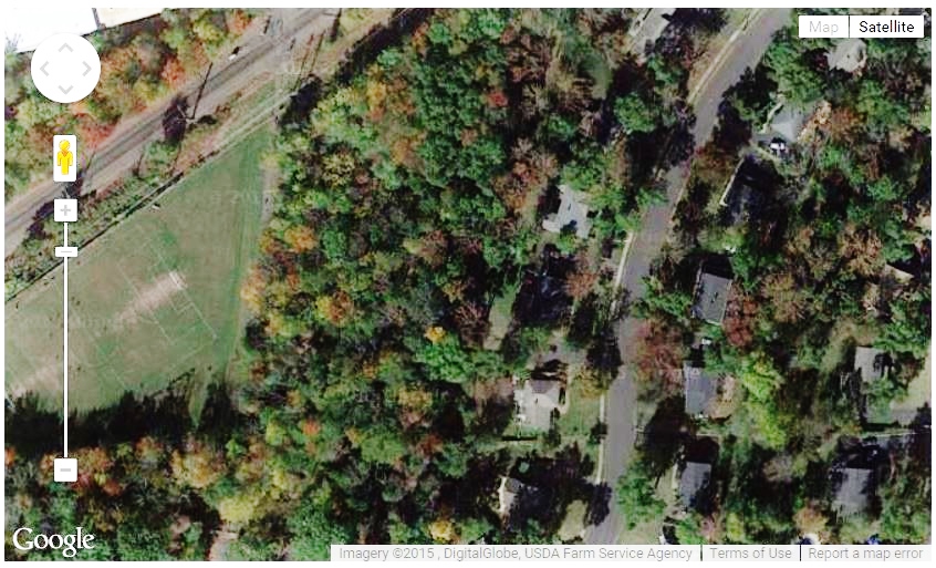

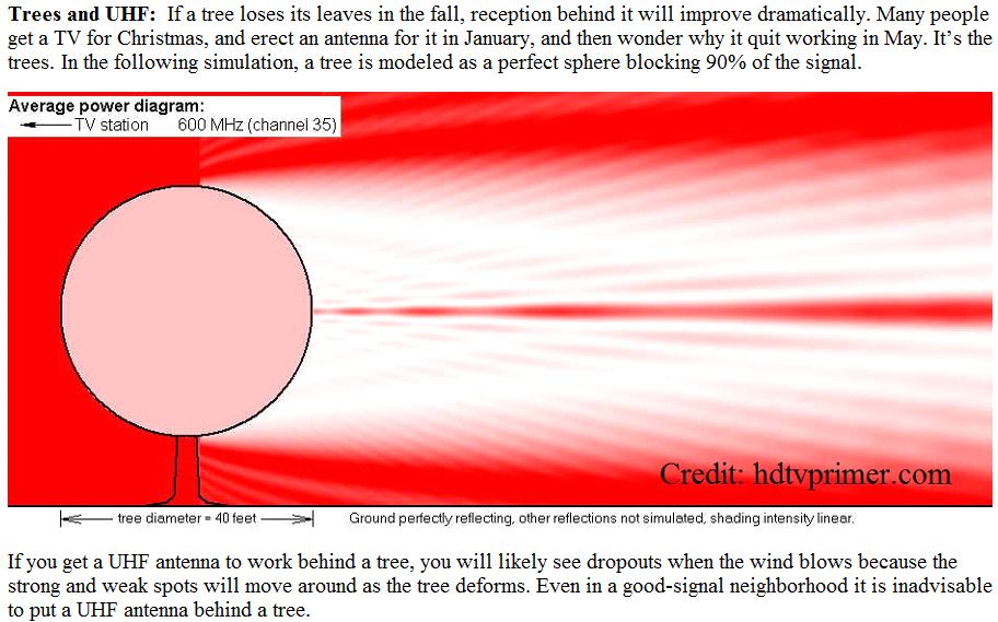

Trees and other buildings will block signals. There is no magic antenna that will "see" through trees. I see a lot of trees in your area. See attachments 3 and 4. As a general rule, a smaller antenna mounted above the trees does better than a larger antenna mounted lower.
