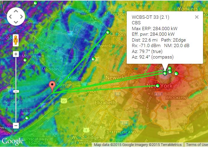

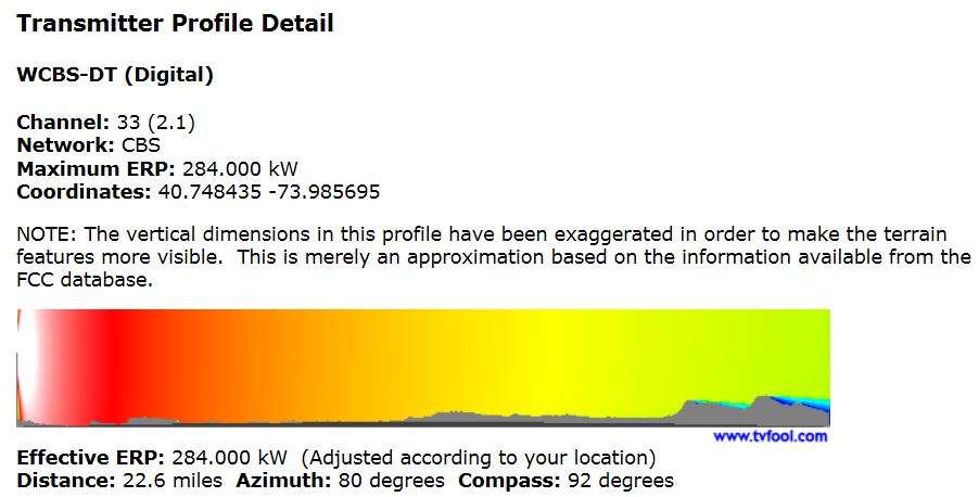

WCBS-DT CBS is a 2Edge signal because of the terrain interference from what I think is the Watchung Mountains. I used to live in NJ and would drive up the mountain for more elevation to operate 2 meter ham radio from my car. If you click on the callsign in your report, you can see the terrain profile. The transmitter is on the left, your location is on the right. See attachment 1.
If you look at the coverage map, you can see that the WCBS signal barely makes it to your location.

Trees and other buildings will block signals. There is no magic antenna that will "see" through trees. I see a lot of trees in your area. See attachments 3 and 4. As a general rule, a smaller antenna mounted above the trees does better than a larger antenna mounted lower.
I don't know if it's a lost cause, you will just have to try it.
