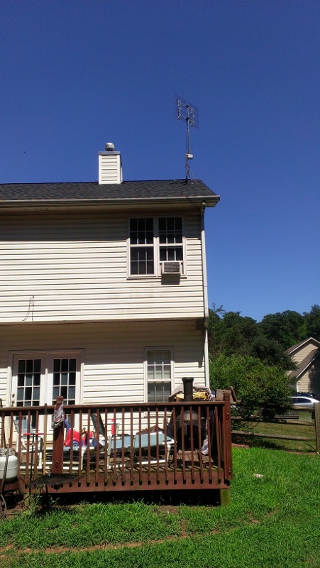

My set up is as follows, DB8 antenna, amp (pictured), RCA rotor. Also posted is my signal report link. If anyone has any suggestions, it would be greatly appreciated.

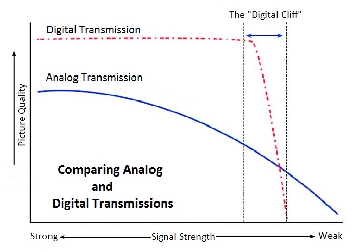

It was the snow that made it possible to get the analog channels. Analog signals fade out gradually because we can tolerate a little snow, but digital signals suddenly drop out at the "Digital Cliff," when the increasing errors are more than the FEC (Forward Error Correction) can correct.

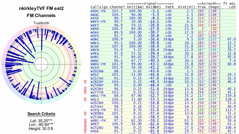

The second obvious problem is from your very strong local FM signals that can interfere with TV reception. You need an FM filter or 2 in series.

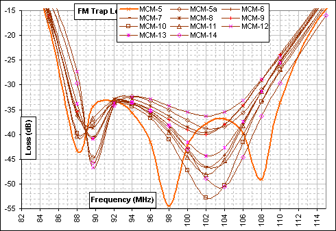

Tell me about the FM filter and where I would put one?
Since you don't have a preamp (I hope) at the antenna, you can put the FM filter, or two in series for extreme cases, just before the CM distribution amp. All FM filters are not equal, so I needed to look at the frequencies of your strongest signals. This filter would be suitable:
Antennas Direct makes one, but it's not quite as good at the high end for WKQC 104.7.
Radio Shack also makes one, but it will not reject the signals at the low end of the FM band effectively (WFAE 90.7).
You can, instead, use a HLSJ to block all signals below channel 7, including the FM band. Use the common and high ports.

Rabbit, I had an antenna guy install the antenna, but, I really don't know what he did as far as grounding. I would have to call him to find out. I am about positive, though, he did not ground anything to the house's electrical box.
I will definitely get the FM filter and give that a shot. That might be just enough to pull in WXII. I viewed your map and you are correct, that signal, if there is one at all, barely gets to my location. I guess that since I have tuned it in from time to time that I thought I might be able to grab it more reliably or frequently if I did a few changes to the antenna, such as raise the antenna.

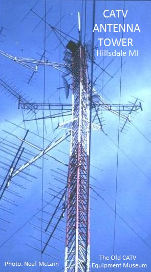

If you looked down the path you could see a very tall, probably two or three hundred feet off the ground, TV antenna that my dad said Cablevision (now Time Warner) used to pick up some of their stations. Like I said, I was a kid, so, we are talking late '70's. Anyhow, I remember at that time, cable offered WSPA and channel 20 out of Washington DC (don't remember their call letters). Anyhow, would a tower that tall actually pick up signals that far way from Charlotte.
Yes, that's the way it was done then.
