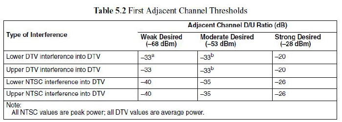

WIS, NBC, real channel 10, NM -12.1 dB, Tropo path, 77.5 mi, 192 degrees magnetic; not much hope for this one. Tropo signals are unreliable, and WIS has adjacent channel interference from WTVI on real channel 11 that is 72.1 dB stronger.
ATSC Recommended Practice:
5.4.2 Adjacent Channel Rejection
The receiver should meet or exceed the thresholds given in Table 5.2 for rejection of first adjacent-channel interference at the desired signal levels shown above the columns therein.

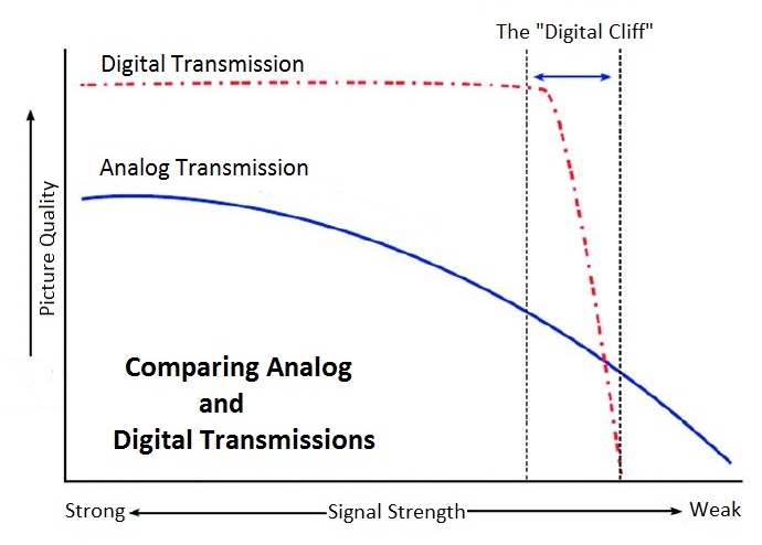

It was the snow that made it possible to get the analog channels. Analog signals fade out gradually because we can tolerate a little snow, but digital signals suddenly drop out at the "Digital Cliff," when the increasing errors are more than the FEC (Forward Error Correction) can correct.
http://forum.tvfool.com/attachment.p...1&d=1435623949

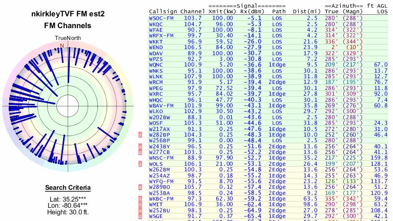

The second obvious problem is from your very strong local FM signals that can interfere with TV reception. You need an FM filter or 2 in series.
http://forum.tvfool.com/attachment.p...1&d=1435626070

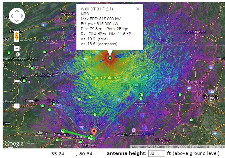

You can see that the WXII signal barely makes it to your location:
http://forum.tvfool.com/attachment.p...1&d=1435627349
color code here:
http://www.tvfool.com/index.php?opti...id=15&Itemid=1

I added another image to my previous post showing WXII signal coverage.

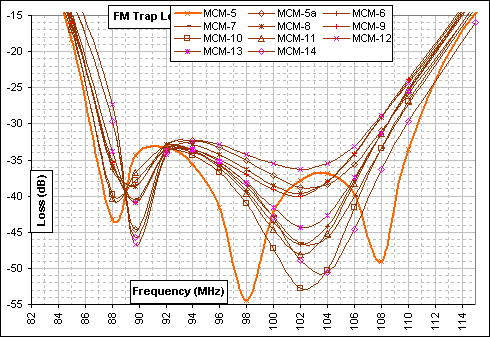

Tell me about the FM filter and where I would put one?
Since you don't have a preamp (I hope) at the antenna, you can put the FM filter, or two in series for extreme cases, just before the CM distribution amp. All FM filters are not equal, so I needed to look at the frequencies of your strongest signals. This filter would be suitable:
http://forum.tvfool.com/attachment.p...1&d=1435663742
Antennas Direct makes one, but it's not quite as good at the high end for WKQC 104.7.
Radio Shack also makes one, but it will not reject the signals at the low end of the FM band effectively (WFAE 90.7).
http://forum.tvfool.com/attachment.p...1&d=1435662622

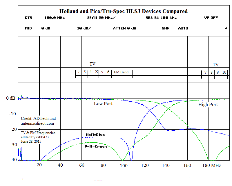

You can, instead, use a HLSJ to block all signals below channel 7, including the FM band. Use the common and high ports.
http://forum.tvfool.com/attachment.p...1&d=1435662850

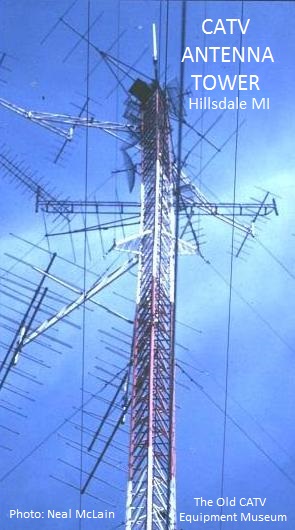

rabbit73 30-Jun-2015 1:28 PM
1 Attachment(s)
If you looked down the path you could see a very tall, probably two or three hundred feet off the ground, TV antenna that my dad said Cablevision (now Time Warner) used to pick up some of their stations. Like I said, I was a kid, so, we are talking late '70's. Anyhow, I remember at that time, cable offered WSPA and channel 20 out of Washington DC (don't remember their call letters). Anyhow, would a tower that tall actually pick up signals that far way from Charlotte.
Yes, that's the way it was done then.

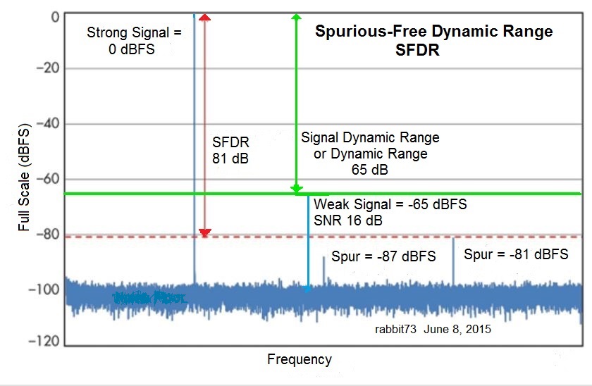

Forum member holl_ands (who is a communications engineer) has made a preamp chart that shows the maximum input signal for preamps. Many of the preamps are no longer available, but it gives you the general idea.
Intermodulation Distortion
The IMD creates new spurious signals within the preamp (or tuner) itself that can interfere with the reception of your weakest desired signals if the spurious signals are stronger than the noise floor of the weakest desired signals. The spurious signals are caused by the interaction between two or more of your strongest signals.
IMD is not the only distortion that can be created within the preamp; you can also have distortion caused by signals so strong that the top of the strong signals are clipped, which causes compression of the signals. This can be seen if you increase the input to the preamp by, for example, 10 dB and the output increases by less than 10 dB.
Spurious Free Dynamic Range
The Spurious Free Dynamic Range needed is the difference in strength between your strongest signal and your weakest desired signal, plus 16 dB for the SNR (Signal to Noise Ratio) of the weakest signal, using the dBm Pwr scale on your tvfool report. This difference is expressed in terms of dB, not dBm, because the original units are the same. The difference between the strongest signal and the weakest signal is the Signal Dynamic Range/Dynamic Range, which is 16 db less than the SFDR, because it doesn't include the SNR of the weakest signal.
http://forum.tvfool.com/attachment.p...1&d=1435674837
Another way to think of SFDR is from the top of the strongest signal down to the bottom (noise floor) of the weakest desired signal. The top of the spurious signals must be at or below the noise floor of the weak signals if they are not to cause interference. The Signal Dynamic Range is from the top of the strongest signal down to the top of the weakest desired signal.
You can also use the NM scale for your calculations, but I prefer to use the Pwr scale because most tuners drop out around -85 dBm.
