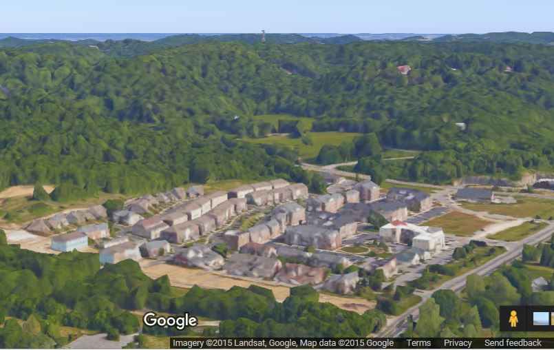

I know the FCC allows me to place an antenna outside but I'm not willing to fight the HOA nazis. So, I've decided on placing it in the attic. Here are some notes:

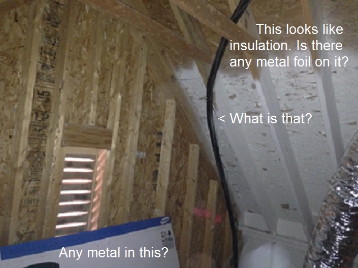

-I can hang it from the joists or screw it down in the attic. It will be about 20 feet above ground. I can squeeze in a 100" long antenna but it's tight and will almost reach the corner. Do I need something that big though?
- There's foil clad return duct to the right of where the antenna will be (just a foot or two to the right) but it won't be in the way. The area has just the ply and joists. Is it a problem if the antenna points to the corner of the attic? The photo shows the corner which is approximately 0 to 4 degrees azimuth. My channels are in the 352 to 8 degrees arc.
- I want to drive the signal to 2 rooms - an upstairs bedroom (about 35 feet away) and a downstairs living room (50 to 60 feet). I think the splitter will be located near the upstairs TV and cable to living room will go another 15 feet down to the living room TV (straight beneath the BR TV).

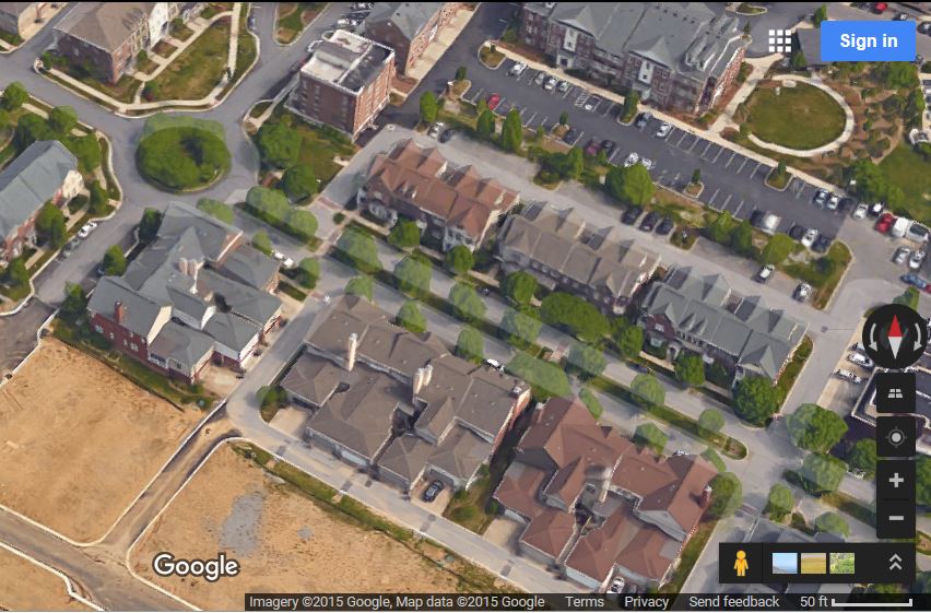

- There is a birch outside about 30 feet from the antenna location but its canopy is slightly to the left of the antenna direction. The peak of the next apartment block is in line of sight and is approx. 150 feet from the antenna. There are more 5 more similar buildings like that at similar height.
- My roof juts out 6 feet beyond the neighbor’s roof. Luckily, that clearance/gap between his roof-edge and the tree is exactly in the direction of the transmitter. Narrow, yes, but I think I'm clear.
- Do I need to ground the antenna if it's placed in the attic?

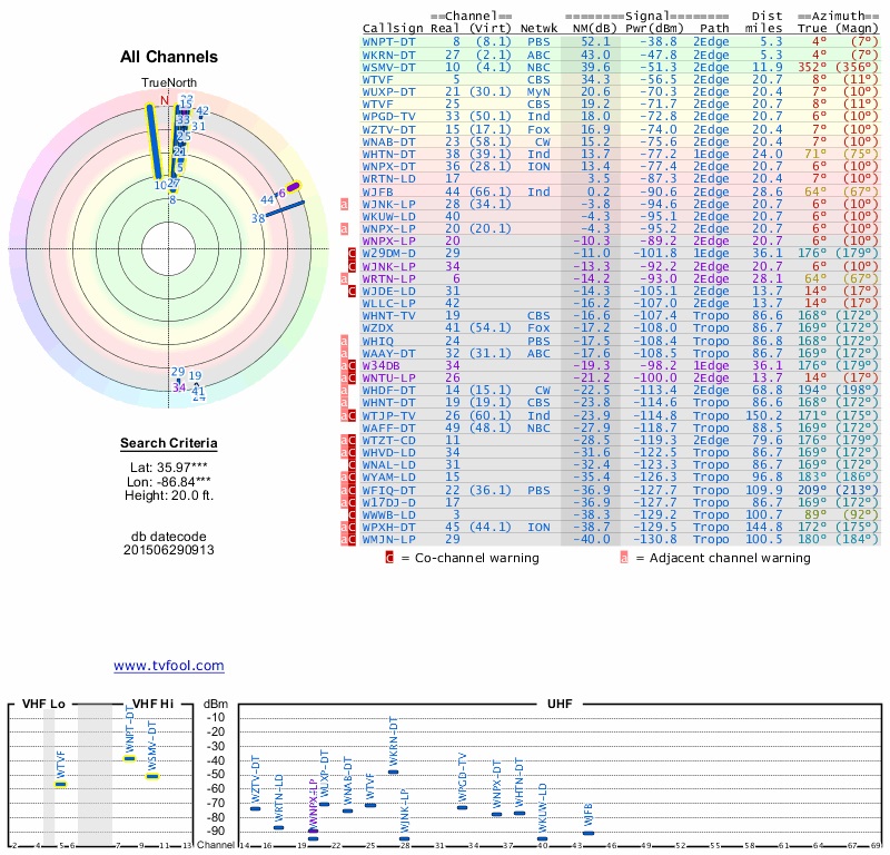

Do us a favor. Go back and get the LINK for your plot, not the image of it. Change the prefix of the link in an obvious manor, then post that modified link. The "live" table allows more in depth analysis.
https://www.fcc.gov/guides/over-air-...n-devices-rule

Here's the link: http://www.tvfool.com/?option=com_wr...8e03280fdea8e9

Thanks for the attic photo. I see the foil clad duct. See attachment 1 for my questions.
The NEC does not require a ground for an attic antenna, but I have found that it is a good idea to ground the coax with a grounding block connected to the house electrical system ground for personal electrical safety. I have had several close calls with electrical shock.

The channels I need are PBS (ch 8 VHF), NBC (ch 10 VHF), ABC and CBS (on UHF).

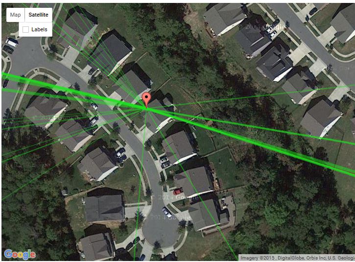

Have you used the green signal lines in the tvfool interactive map browser? See attachment 2 for an example.
Is it worth it to get a separate antenna such as ClearStream 5 just for one H-VHF channel (the important PBS?) or could I use an antenna than can do H-VHF well and UHF.
Because your signals are in the same general direction, you can use separate VHF and UHF antennas or a combo antenna.

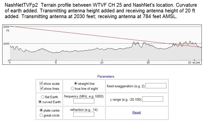

To meet your requirements you will need WTVF CBS on real channel 25, because CBS on real channel 5 is VHF-Low that would require a very large antenna. Your CBS channel is much weaker than your strongest channels, there is the attic loss to consider, and there is a hill and other buildings in the signal path, all of which indicate a need for extra UHF gain in the antenna. Your tvfool report is a computer simulation that assumes your antenna is outside and in the clear, with no trees or other buildings in the signal path. The hill:
http://www.tvfool.com/?option=com_wr...dALLTV%26n%3d6
Here is another terrain profile that shows the hill is in the signal path:
See also attachment 3.
Possible choice: DB4e with VHF add-on dipole kit, but I want ADTech to double check my analysis if he has time.

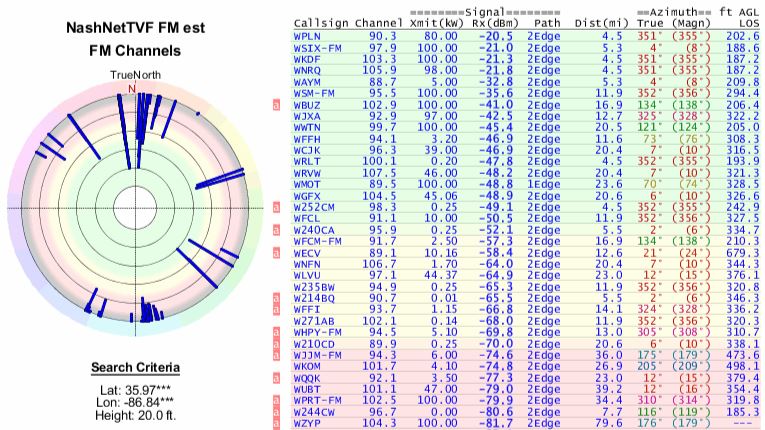

You have some strong local FM signals that might interfere with TV reception and require an FM filter in the coax line.

Is there a solution at all that I could experiment in the attic or should I just forget this whole thing and just stick with the blood-sucking cable provider.
You will never be happy until you try the attic. Success is possible if you do; failure is 100% certain if you don't. Even if you can't return the antenna if it doesn't work, your peace of mind is worth the money spent and you can take the antenna with you when you move.
I don't watch the TV show Roseanne very often, but I recall her saying: "It's important for a wife to let her husband have his dreams so that he doesn't notice that she is running his life."
I'm very lucky that my wife tolerates my antenna experiments. She knows that I will stay at home to do that, instead of wandering off somewhere else. And she knows that I get depressed if I don't have a "project" to work on. She has been supportive to the extent that she even bought a signal level meter for me.
I have described the possible signal impediments and listed the possible antennas to try. I can't do it for you because I'm too far away; you must do it for me so that I will know what works. My advice is based on feedback.
Where would you start?
It doesn't really matter where you start, as long as you DO start. It doesn't have to be perfect because you are doing an experiment to see what works. The results of the experiment will tell you what direction to take next.
You have reached the point with your project that also gives me trouble because of so many options. I deal with it by starting anywhere and the results tell me what to try next.

He said "even after we move out of the condo in a year."
He hasn't given me his exact address by PM, but it is probably one of these:
