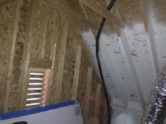

I've decided on cutting the cord and I feel so free already. I moved from FIOS in NJ to Comcast in Nashville. Different providers, same suckee suckee. I'm new to OTA DTV and learning but "the more I know the less I know." Essentially, I'm confused. My budget is $150-$200 but I think I can convince her about an investment that will last long - even after we move out of the condo in a year. I'd appreciate your thoughts and advice. The channels I need are PBS (ch 8 VHF), ABC, CBS, and NBC (all on UHF). (I'm going to subscribe for services that give me sports and HBO).
I know the FCC allows me to place an antenna outside but I'm not willing to fight the HOA nazis. So, I've decided on placing it in the attic. Here are some notes:
-I can hang it from the joists or screw it down in the attic. It will be about 20 feet above ground. I can squeeze in a 100" long antenna but it's tight and will almost reach the corner. Do I need something that big though?
- There's foil clad return duct to the right of where the antenna will be (just a foot or two to the right) but it won't be in the way. The area has just the ply and joists. Is it a problem if the antenna points to the corner of the attic? The photo shows the corner which is approximately 0 to 4 degrees azimuth. My channels are in the 352 to 8 degrees arc.
- I want to drive the signal to 2 rooms - an upstairs bedroom (about 35 feet away) and a downstairs living room (50 to 60 feet). I think the splitter will be located near the upstairs TV and cable to living room will go another 15 feet down to the living room TV (straight beneath the BR TV).
- There is a birch outside about 30 feet from the antenna location but its canopy is slightly to the left of the antenna direction. The peak of the next apartment block is in line of sight and is approx. 150 feet from the antenna. There are more 5 more similar buildings like that at similar height.
- My roof juts out 6 feet beyond the neighbor’s roof. Luckily, that clearance/gap between his roof-edge and the tree is exactly in the direction of the transmitter. Narrow, yes, but I think I'm clear.
- Do I need to ground the antenna if it's placed in the attic?

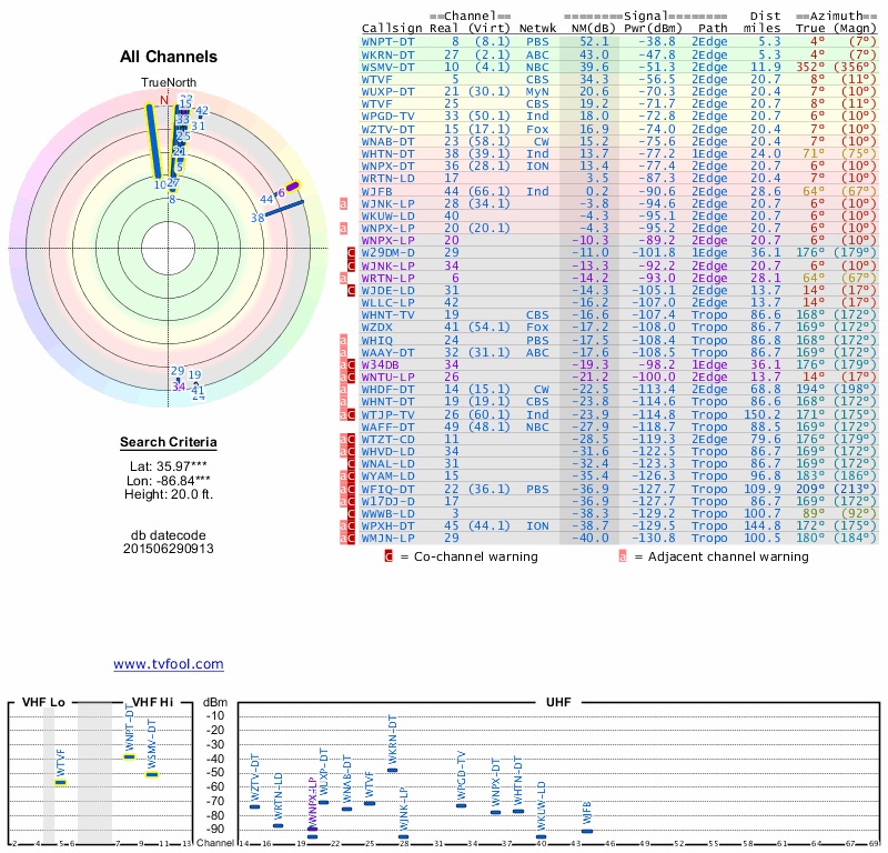

Do us a favor. Go back and get the LINK for your plot, not the image of it. Change the prefix of the link in an obvious manor, then post that modified link. The "live" table allows more in depth analysis.
https://www.fcc.gov/guides/over-air-...n-devices-rule
NashNet 9-Oct-2015 7:08 PM
Thank you, AdTech!
Here's the link: http://www.tvfool.com/?option=com_wr...8e03280fdea8e9

The signal loss for an attic location is difficult to predict because of differences in construction. You need to be prepared to make some tests with a temporary setup.
Thanks for the attic photo. I see the foil clad duct. See attachment 1 for my questions.

Have you used the green signal lines in the tvfool interactive map browser? See attachment 2 for an example.
Is it worth it to get a separate antenna such as ClearStream 5 just for one H-VHF channel (the important PBS?) or could I use an antenna than can do H-VHF well and UHF.
Because your signals are in the same general direction, you can use separate VHF and UHF antennas or a combo antenna.
To meet your requirements you will need WTVF CBS on real channel 25, because CBS on real channel 5 is VHF-Low that would require a very large antenna. Your CBS channel is much weaker than your strongest channels, there is the attic loss to consider, and there is a hill and other buildings in the signal path, all of which indicate a need for extra UHF gain in the antenna. Your tvfool report is a computer simulation that assumes your antenna is outside and in the clear, with no trees or other buildings in the signal path. The hill:
http://www.tvfool.com/?option=com_wr...dALLTV%26n%3d6
Here is another terrain profile that shows the hill is in the signal path:
http://forum.tvfool.com/attachment.p...2&d=1444528042
See also attachment 3.
