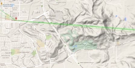

That's why I'm asking- there is a little difference and I'm not sure if it matters.
I'm a lot closer to the hills than they are. They are ten miles farther but the terrain is different.
I have mostly a 2edge path and they have mostly a 1edge path, does that matter?

Being further away does help. However, what I estimate as their signal path happens to pass through a notch in two hills which makes for multipath hell.
