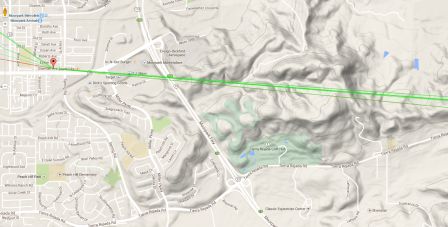

ADTech 22-Apr-2015 6:48 PM
1 Attachment(s)
Being further away does help. However, what I estimate as their signal path happens to pass through a notch in two hills which makes for multipath hell.
http://forum.tvfool.com/attachment.p...1&d=1429724873
