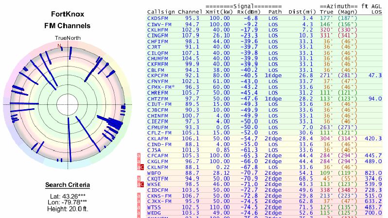

A CM7777 is certain to overload from a -17.1 dBm signal.

You also have some very strong FM signals:
