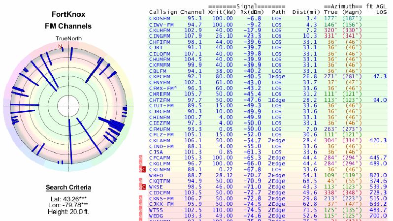

You also have some very strong FM signals:
http://forum.tvfool.com/attachment.p...1&d=1412307736
