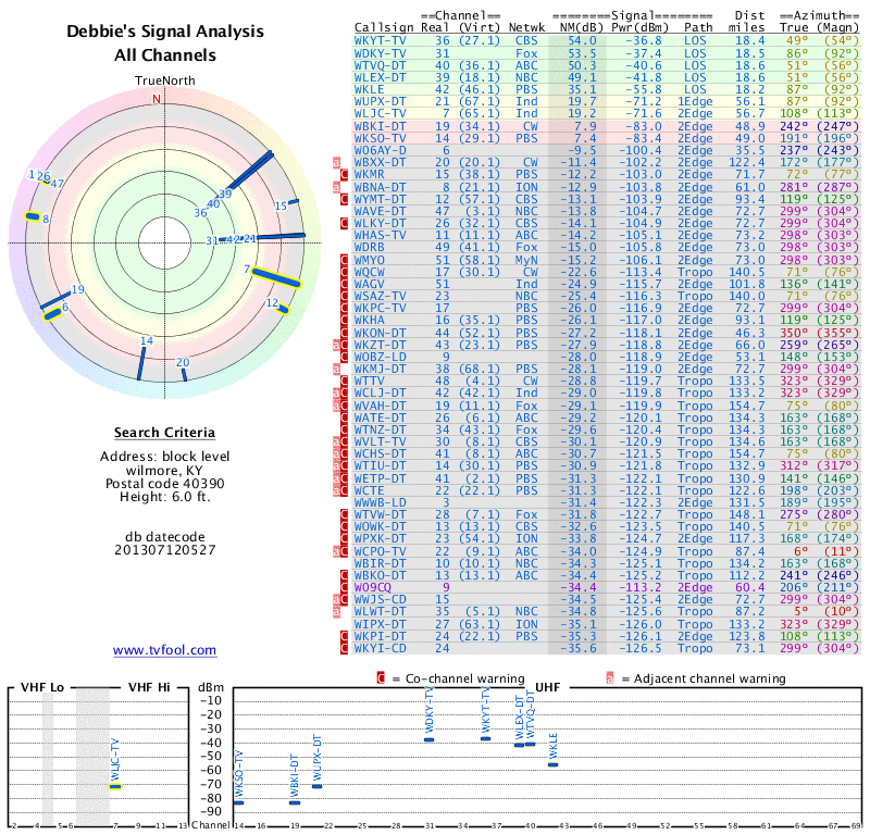

I do have the analysis report for my area. and the channels I was getting were all listed in the green circles. ABC, NBC, CBS, FOX plus some Ky educational channels as well, which aren't as important to me. The other four are.
Analysis attached.

It sounds as if the amplifier built into the antenna has lost power or has failed. The least expensive test I can think of is to get an inexpensive non-amplified antenna to test with.
http://forum.tvfool.com/showthread.php?t=2828
My suggestion would be the Terk HDTVi (not the HDTVa).
