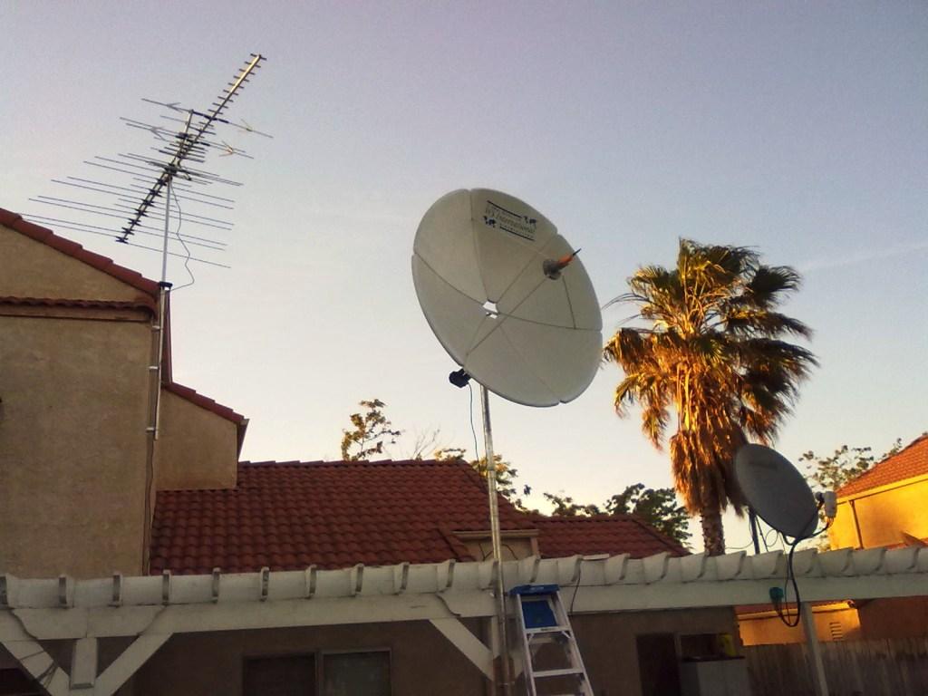

I live in Palmdale and have a Winegard HD8200U with Winegard AP8275 Preamp. I get the PBS stations very good and live where you wouldn't think would get it. Mesa Verde Avenue in Palmdale off 5th West. I get all the local except for channel 5, not sure why I can't get it.

The (CW) 5.1 channel is very weak. Maybe the transmitter is further around the mtn or not as strong. I get 5 KCET channels that come in very clear. Here's my report.
http://www.tvfool.com/?option=com_wr...03d9c9ec58d50a
I also use a 25 db booster on my older LG LCD, the tuner is not as strong as the new Samsung I have. You're further out than I am, but have more chance of the signal reflection than I do since I am so close to the mtn here. I'm not sure about KSCI, I'll check tonight exactly which UHF channels I pick up.

I remember we talked last year when I first mounted the antenna. I am still looking to put a rotor on it, but I'm waiting for the right price on a heavy duty ham mover on ebay, I've seen a few, but always got past my bid when I was at work.
