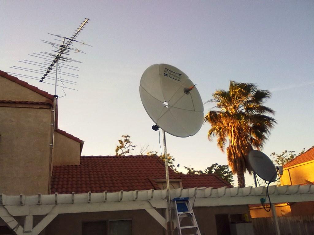

BrettBA 13-Jul-2011 4:48 AM
channel clarity
1 Attachment(s)
All the channels I get are very clear and crisp HD really steady and no ghosting/tracking/etc except when the wind is shaking the antenna. It probably is America One as you mentioned. I haven't had the TV on OTA for a couple of days as I just got my BUD and smaller dish connected after shutting off DirecTV. I'm still programming channels and transponder frequencies into the FTA receivers and I noticed today I need to go up to the OTA antenna and put a different bolt into the wall for the top restraint mount and add some guy wire due to the wind blowing so hard over the last few months it's loosened one side of the mount. Won't do to have it come loose and come down. It's mounted on 10' of 1-1/2" EMT about 4 feet above the roof line with 4 standoff mounts on the wall. I want to add another mount and the guy wire this weekend if I have time. Here's a picture of my current setup.Attachment 210
BrettBA 13-Jul-2011 4:55 AM
John,
I remember we talked last year when I first mounted the antenna. I am still looking to put a rotor on it, but I'm waiting for the right price on a heavy duty ham mover on ebay, I've seen a few, but always got past my bid when I was at work.
