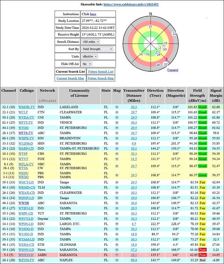

Hello, Shannon. Thank you for the TVFool signal report.
Unfortunately, TVFool reports are no longer very accurate because their database is out of date.
I did an estimated report using the rabbitears.info Signal Search Map which gave this result
https://www.rabbitears.info/searchma...udy_id=1861492
Please doublecheck my estimate for 1788mom here:
