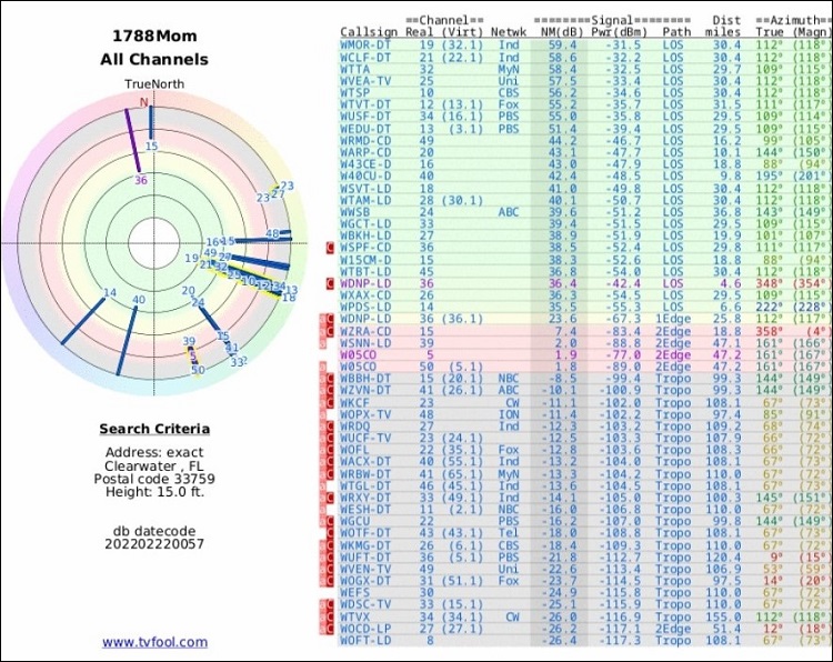

Looking for recommendations for Clearwater FL. 2 TVs running from a Tablo.
Here is my report.
http://www.tvfool.com/?option=com_wr...b0fe35236a6e2b

Hello, Shannon. Thank you for the TVFool signal report.
https://forum.tvfool.com/attachment....1&d=1734894689
Unfortunately, TVFool reports are no longer very accurate because their database is out of date.

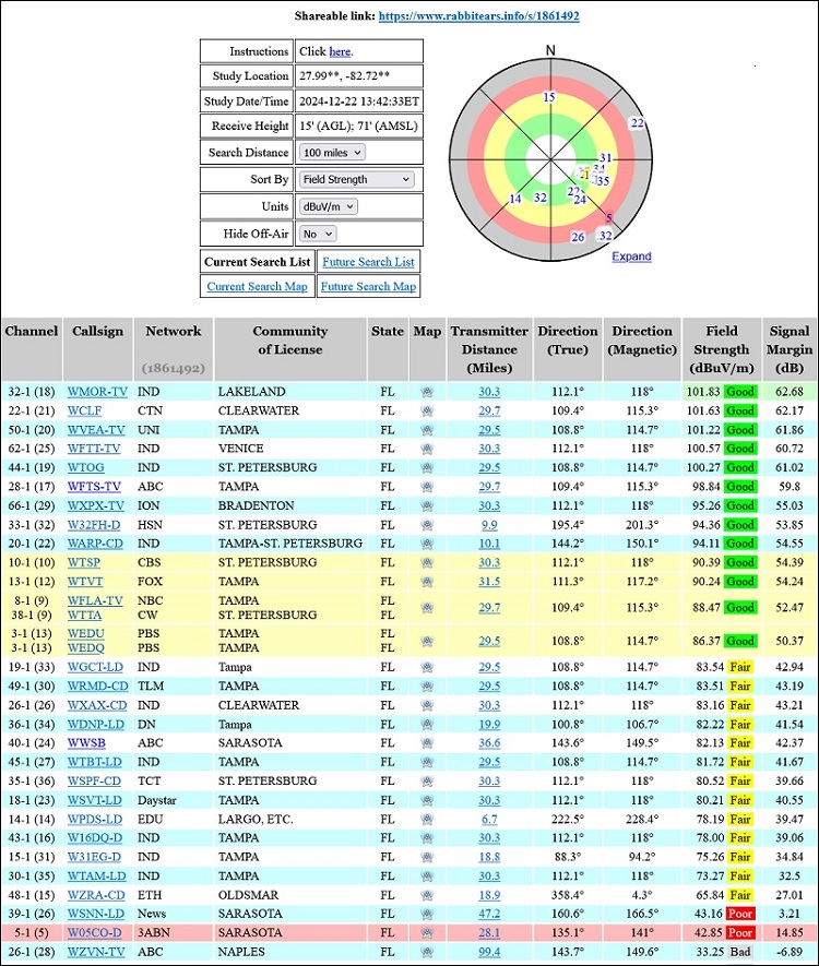

I did an estimated report using the rabbitears.info Signal Search Map which gave this result
https://www.rabbitears.info/searchma...udy_id=1861492
https://forum.tvfool.com/attachment....1&d=1734896490
Please doublecheck my estimate for 1788mom here:

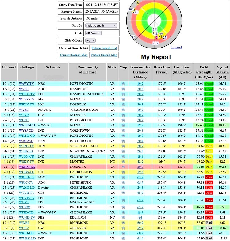

Your signal report looks a lot like my report:
https://forum.tvfool.com/attachment....1&d=1735157183

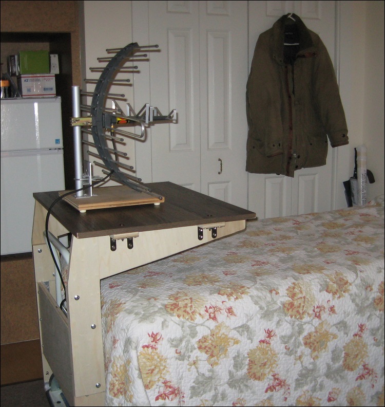

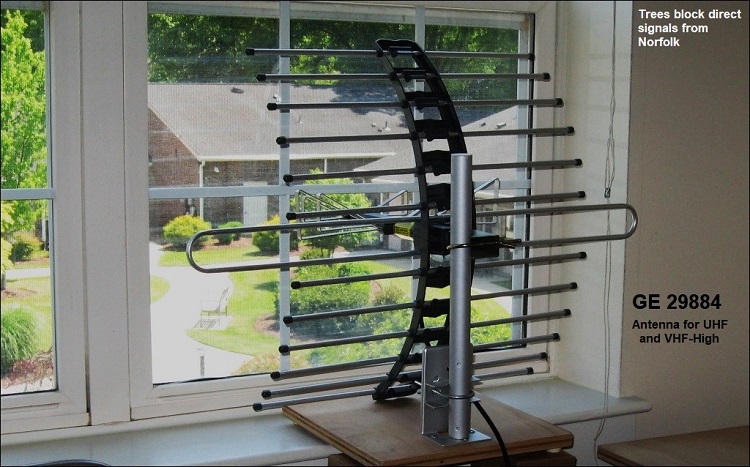

I'm using a GE 29884 antenna indoors
https:www.amazon.com/GE-Outdoor-Supports-Included-Resistant/dp/B01MYMVPVX/ref=asc_df_B01MYMVPVX?th=1
and am able to receive down to RF 7 WTPC TBN:
https://forum.tvfool.com/attachment....1&d=1735157825
It works a little better over the bed where there is less electrical noise (EMI) on VHF-High channels 7-13:
