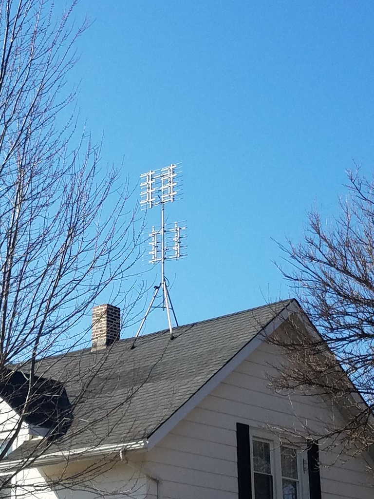

Hi all,
I would like feedback from all members here!
I live near the Wisconsin border, still in Illinois, 39 miles north of Chicago and 46 miles south of Milwaukee. Here in Illinois, it's not so common to see rooftop or towered antennas. I guess we got cable several years earlier than WI or is it that the Chicago market was/is more desirable than Milwaukee and less people had rooftop antennas and just let them got to hell and junked them on the next re-roof?
Anyhow, I'm kind of an antenna spotter.
Just across the state line is Kenosha WI. Antenna-town USA.
Kenosha is former home of Nash then Rambler, AMC and then Chrysler. And Kelvinator AMC refrigerator division. All are gone now. Snap-on tools has worldwide headquarters there. 100,000 strong, mostly single residence. Lot's of antennas.

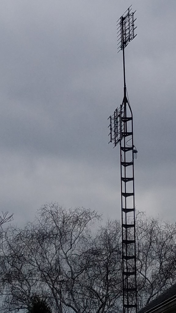

Anyhow, Kenosha has the most antenna towers I've ever seen. It's like an outdoor antenna museum, stuff from the 50's, most still aimed in the proper orientation either towards Chicago or Milwaukee. I see a lot of old antenna pairs also opposed, pointed at either city. I always wonder how well they work. My luck with combing antenna was very spotty.
Lately, as I gaze skyward have been seeing a hell of a lot of 8 bay antennas, very shiny, a lot are new, doubled up and set up in opposed directions. This must be working for my area.
So, here's my question, as I may ultimately do something similar.
Even though these are matching antennas I wonder what luck they have by combining them? Or are they? Maybe separate inputs at the TV?
Why not just remove the reflectors and get both directions since Chicago is 168 south and Milwaukee 353 north? This almost 180 degrees opposite.
Just think, in a perfect world they could remove the reflectors, combine the antennas and increase the strength.
I also see this combination a lot, the famous "crazy 8's" as I call them, the C4 & C4-Max:
Here's a typical TV Fool report for the area:
http://www.tvfool.com/?option=com_wr...903811d4bb07df
Any opinions?

Greetings from Arizona Bob,
Combining two UHF antennas pointing in opposite directions is a
hit or miss proposition. Usually, one or more signals gets cancelled
out. Best success would be accomplished with two UHF antennas
WITH reflectors and two separate RG6 cables to each television.
Use an A/B switch or a second tuner at the televisions to watch either
Milwaukee or Chicago. We have very weak signals here, mostly translators,
at nearly 180 degrees opposite. I've yet to view any antennas with no
reflectors or two UHF antennas pointed in the opposite direction. They
just do not work that well.
Old 26-Mar-2019, 1:26 PM   #3

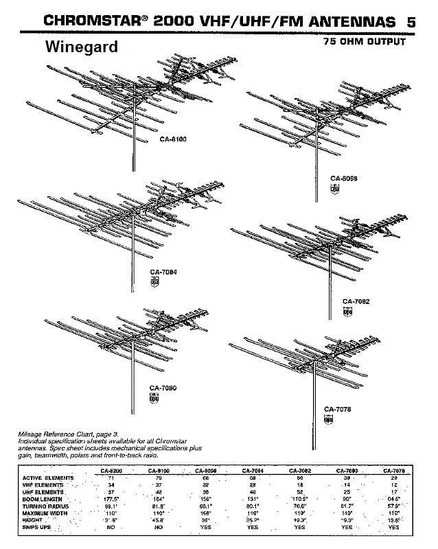

To me, those were exciting times for the antenna world. I always wanted one of those CA8100s, to me, that was the ultimate statement. A completely impractical antenna by today's standards.
OK, I think I found it.
Originally Posted by Rick0725 View Post
A trip down memory lane and my old Winegard antenna spec. sheet....see attached.
That antenna (The Winegard Colortron Color Wedge Antenna) evolved into the Winegard CA8100 in the 80's and was discontinued about a dozen years ago. The CA8100 was a tadd shorter than the CA8200 which evolved into the HD8200P now the hd8200U.
The Hd8200U would be a tadd better than the antenna you mention
File Type: jpg Winegard Colortron Color Wedge Antenna_1.jpg (138.8 KB, 5486 views)
File Type: jpg Winegard Chromstar 2000 Antennas_1.jpg (153.5 KB, 5452 views)

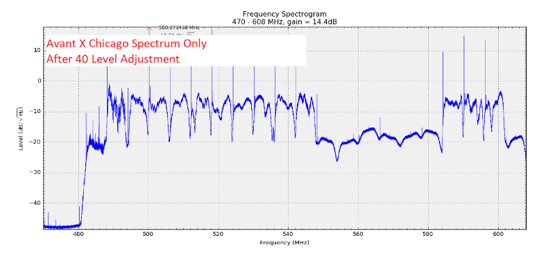

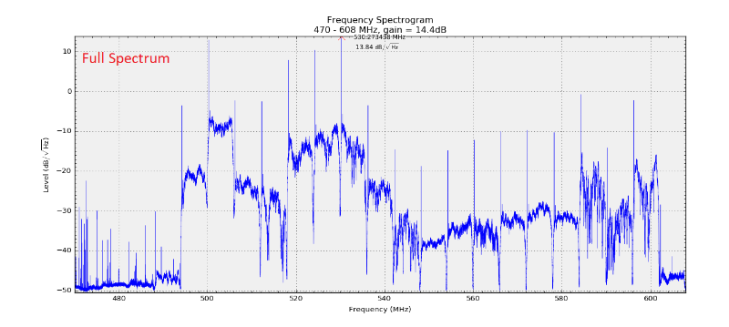

In the end, I discovered the Avant X. Now I have no issues whatsoever. I looked at both spectrums before and after the Avant X.
When both spectrums are combined the signal is degraded:
With the Avant X I can get the full strength of all my channels with two antennas pointed in a different direction:
