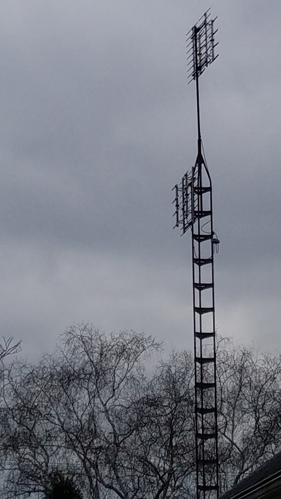

Kenosha is former home of Nash then Rambler, AMC and then Chrysler. And Kelvinator AMC refrigerator division. All are gone now. Snap-on tools has worldwide headquarters there. 100,000 strong, mostly single residence. Lot's of antennas.
Anyhow, Kenosha has the most antenna towers I've ever seen. It's like an outdoor antenna museum, stuff from the 50's, most still aimed in the proper orientation either towards Chicago or Milwaukee. I see a lot of old antenna pairs also opposed, pointed at either city. I always wonder how well they work. My luck with combing antenna was very spotty.

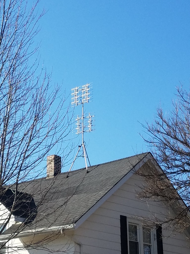

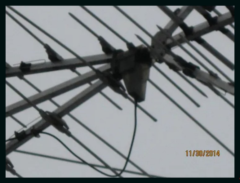

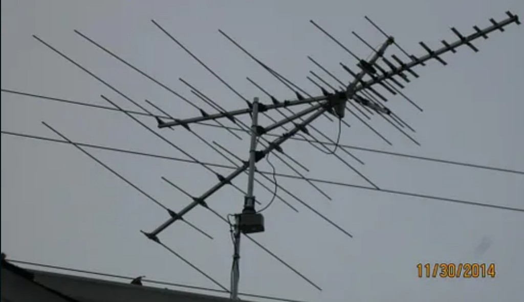

Lately, as I gaze skyward have been seeing a hell of a lot of 8 bay antennas, very shiny, a lot are new, doubled up and set up in opposed directions. This must be working for my area.
http://forum.tvfool.com/attachment.p...1&d=1553560588
So, here's my question, as I may ultimately do something similar.
Even though these are matching antennas I wonder what luck they have by combining them? Or are they? Maybe separate inputs at the TV?
Why not just remove the reflectors and get both directions since Chicago is 168 south and Milwaukee 353 north? This almost 180 degrees opposite.
Just think, in a perfect world they could remove the reflectors, combine the antennas and increase the strength.

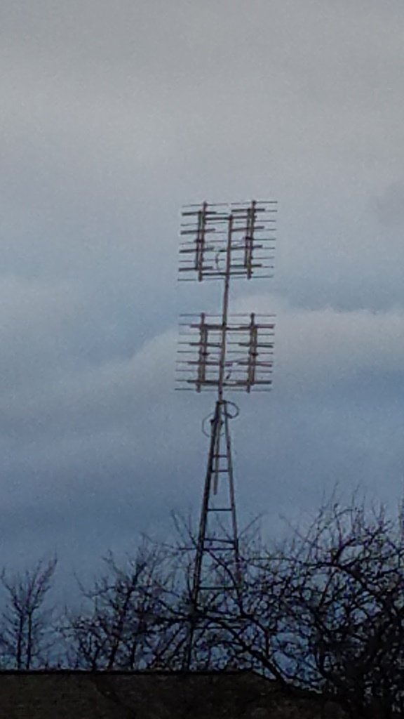

I also see this combination a lot, the famous "crazy 8's" as I call them, the C4 & C4-Max:
http://forum.tvfool.com/attachment.p...1&d=1553561360

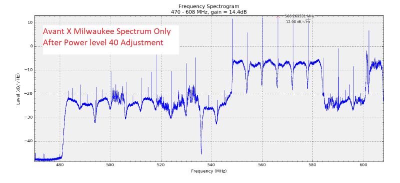

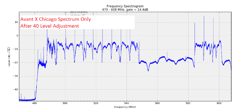

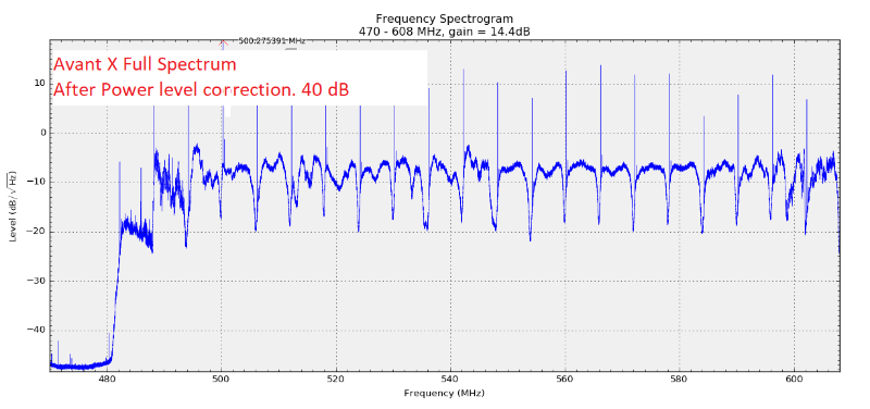

In the end, I discovered the Avant X. Now I have no issues whatsoever. I looked at both spectrums before and after the Avant X.
http://forum.tvfool.com/attachment.p...1&d=1617886285
http://forum.tvfool.com/attachment.p...1&d=1617886329

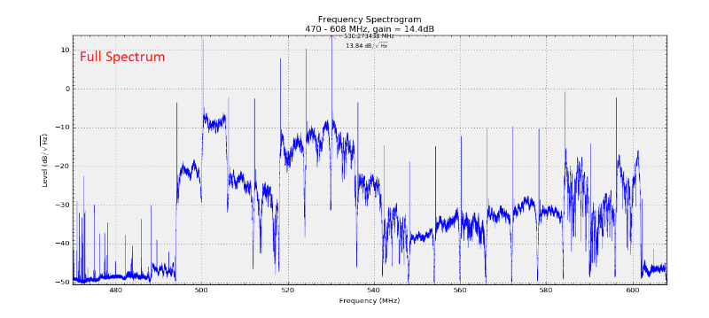

When both spectrums are combined the signal is degraded:
http://forum.tvfool.com/attachment.p...1&d=1617886374
With the Avant X I can get the full strength of all my channels with two antennas pointed in a different direction:
http://forum.tvfool.com/attachment.p...1&d=1617886411
