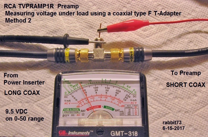

First you have to measure the voltage coming out of the power inserter.
Next, you have to measure the voltage at the preamp when it is connected to the upper end of the coax. This is difficult to do, because you need access to the center conductor of the coax when it is connected to the preamp.
I use a coax T-adapter:
