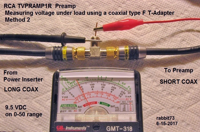

In order for the preamp to receive power from the power inserter, current must be able to flow on the center conductor and the shield of the coax that is between the preamp and the power inserter.
It sounds like when you allow the connector to touch the mast, current is allowed to flow to the preamp.
If it isn't that, it could be an intermittent connection in the coax. There are three possibilities:
1. An open in the center conductor
2. An open in the coax shield
3. A short between the center conductor and the shield, often caused by a strand of the shield making contact with the center conductor inside the coax connector
First you have to measure the voltage coming out of the power inserter.
Next, you have to measure the voltage at the preamp when it is connected to the upper end of the coax. This is difficult to do, because you need access to the center conductor of the coax when it is connected to the preamp.
I use a coax T-adapter:
http://forum.tvfool.com/attachment.p...8&d=1511635684
http://forum.tvfool.com/attachment.p...9&d=1598546702

Using a test procedure from Channelmaster support, I figured out the problem: dodgy coax from power supply to preamp. More than likely an open in the shield, as you mentioned.
Wiggled and jiggled cable and it is working normally at the moment. Replacing cable this weekend.
