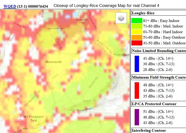

GroundUrMast gave you a link above that shows the terrain profile for the WQED signal. This is another profile using different software:
The Longley-Rice coverage map for WQED on channel 4 looks like it might put you in the yellow, which is encouraging:
This is the link to the full coverage map;
https://www.rabbitears.info/contour....5&site=1&map=Y
