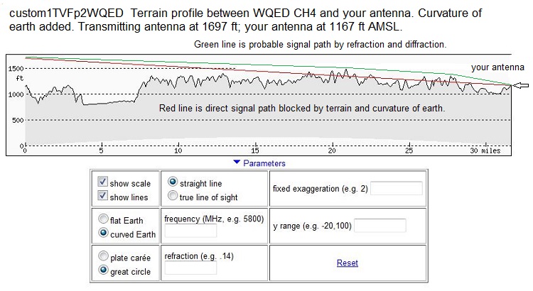

rabbit73 10-Aug-2019 7:02 PM
3 Attachment(s)
GroundUrMast gave you a link above that shows the terrain profile for the WQED signal. This is another profile using different software:
https://forum.tvfool.com/attachment....9&d=1565483696
