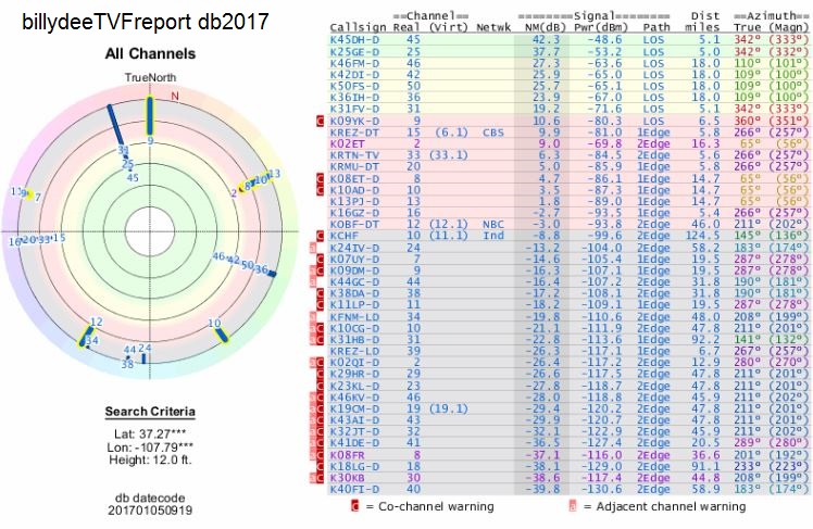

You have two channels with a virtual 20.1 number, KRMU and K36IH which is a translator for KRMU.
Try going into the channel menu for that TV and see if you can get it to ignore one of them.
