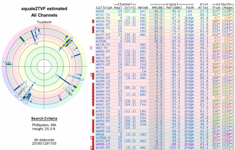

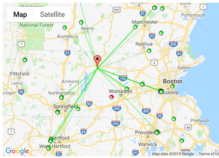

Hello, squale2, welcome to the forum.
Please do another signal report. When I click on your link, it says your report is no longer on the TVFool server.
The total loss of signals that later come back can be caused by atmospheric conditions that result in temperature changes.
What antenna are you using now and where is it located?
I have 3 to 4 TV's's that I would like to have connected.
First, get the channels you want for just one TV, then you can split the signals for other TVs. What channels are most important to you?
When I do a generic report for Phillipston MA, I see weak channels, but your exact address (which will not show) report would be more accurate.
http://www.tvfool.com/?option=com_wr...9038a679fd9c87
Originally Posted by timgr View Post
The group of stations to your southwest are from Hartford (WTIC) and Springfield (WGBY). The alternative to that group is to try for the Boston stations (WGBH 122 magnetic). It would be interesting to see which stations become stronger as you go higher.
Here is a report from rabbitears.info with a more accurate list of channels that shows the two directions close in strength. I favor the SW unless you have local objects in the signal path like trees:
