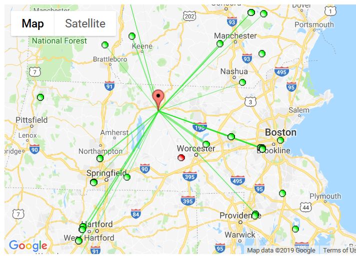

I'm here in Phillipston Ma - what would cause my antenna to lose total signal to all channels and then later in the day it comes back. This all of sudden started happening over and over throughout the day. Is this a tower problem or maybe something to do with my antenna. How can I troubleshoot??? any help would be appreciated

Please do another signal report. When I click on your link, it says your report is no longer on the TVFool server.
The total loss of signals that later come back can be caused by atmospheric conditions that result in temperature changes.
What antenna are you using now and where is it located?

When I do a generic report for Phillipston MA, I see weak channels, but your exact address (which will not show) report would be more accurate.

Here is a report from rabbitears.info with a more accurate list of channels that shows the two directions close in strength. I favor the SW unless you have local objects in the signal path like trees:
