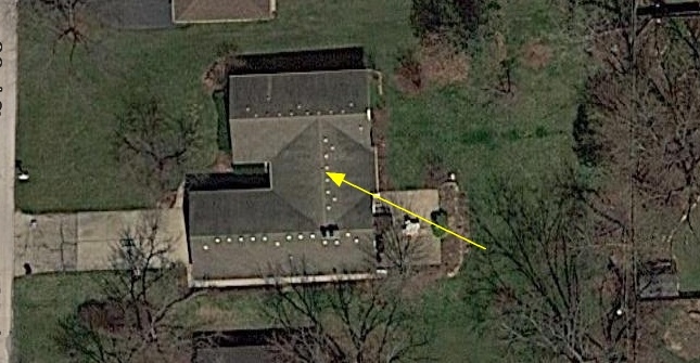

I have attached a google maps photo of my house. The yellow arrow attempts to depict the approximate direction of the signal from the source to my antenna, which is located in the attic at the head of the arrow.
As for growth of trees, I live in a mature neighborhood and I can't imagine there has been any significant tree growth that could be suddenly causing these issues. In general the tree density is what I would consider moderate-- there are trees around but I'm not in the middle of a forest or anything. Likewise, my 'burb is a fairly sleepy one with no buildings over two stories for miles around. Terrain is generally very flat all the way to the source of the signal.
House construction is 2 x 4 exterior walls, cedar siding. Built in the 60's. Roof is typical asphalt shingles (one layer).
If there are any other photos that might help diagnose the problem, just let me know and I will happily accommodate.

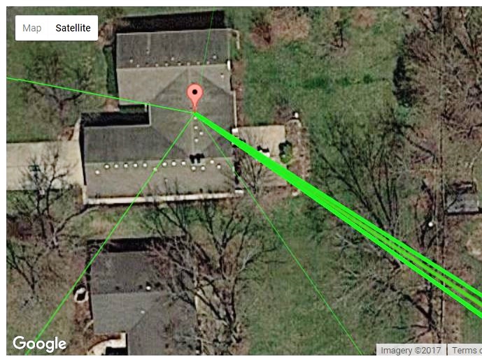

If you use the TVFool Interactive map, you can add the green signal lines.
The satellite image was taken when the leaves were off the trees.
I have looked at some ground photos of your location by Google and Bing showing trees that might interfere with TV reception. Please see the PM I sent to you.

A photo looking from the rear of the house toward 125 true/129 degrees magnetic might be helpful.
If the antenna were moved a little down south in the attic, it might aim between the two largest trees in the SE. That might be difficult with your big all-channel antenna.
A UHF-only antenna would be easier to move around in the attic, but you would still need a VHF-High antenna for WBBM CBS on real channel 12.
Another possibility would be an antenna outside that aims below the lower branches, or an outside antenna aimed between the trees.

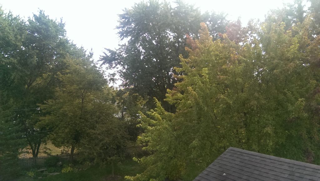

Wow, I can't thank you enough for the attention you've given to my little problem. (Your PM's have the correct house). I've attached a picture from the roof standing right over the antenna position pointing towards the signal source.

Thanks for the photo from your roof. It shows trees thick enough to interfere with TV signals, especially when wet. I wonder how the reception will be when the leaves fall.
