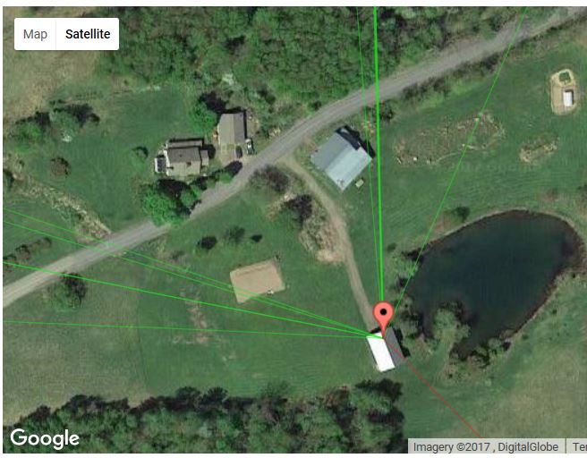

Do I have the antenna on the right building?

The building you chose is actually across the road from my house and garage. The original location i had my first antenna is to the right of the one you picked by the road, the garage location is to the right of the house. I appreciate your help on this. The color coding is a bit hard to differentiate, but telling me that the chart was in order of strength was very helpful. You suggested a style of antenna, pre amp and wire. I have a spool of rg6 18awg broad beam premium Honeywell wire. Any suggested vendors or exact equipment models would be of great help. Those google earth maps always surprise me, the eye in the sky is all knowing!
If one places the antenna at the location of the chimney of the house (the house across the main road running east/west), the plot is quite different. It looks like there is a hill due south of the house, with the white roof building near the pond on higher ground.
Here are a few plots:
- 20 FT: http://www.tvfool.com/?option=com_wr...e6a47d93b26301
- 30 FT: http://www.tvfool.com/?option=com_wr...e6a41b7921ed3d
- 40 FT: http://www.tvfool.com/?option=com_wr...e6a460e637561e
Note that at 20 FT, WBNG (CBS) Real Channel 7 is at -6.2 and at 40 FT it rises to 16.8. You'll need to experiment, but your best chance is probably going to be to aim to the stations north of you, in Utica.
