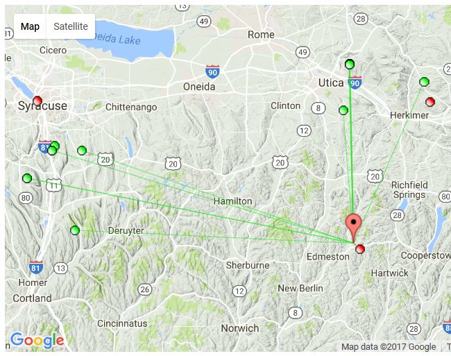

3 Attachment(s)
The signals in the report are listed in order of decreasing strength, so WFXV is your strongest signal.
The colors green, yellow, red, and grey in the report and the compass diagram are the same and indicate the difficulty of reception. They are defined in TV Signal Analysis FAQ:
http://www.tvfool.com/index.php?opti...ask=view&id=57
http://forum.tvfool.com/attachment.p...1&d=1501512769
http://forum.tvfool.com/attachment.p...1&d=1501513907

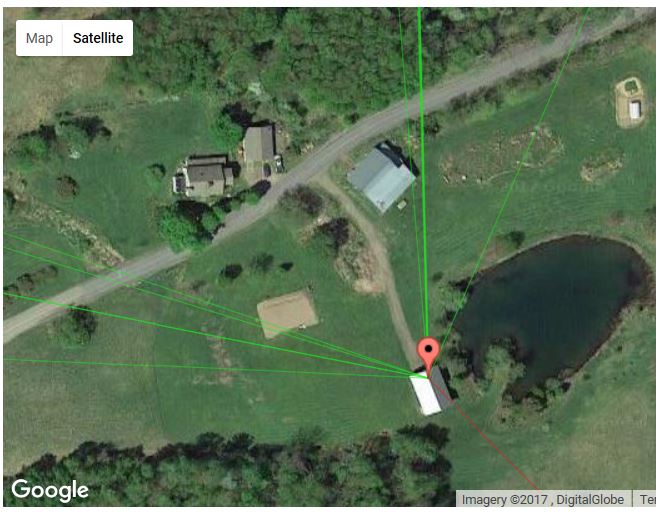

Do I have the antenna on the right building?
http://forum.tvfool.com/attachment.p...1&d=1501515136

garycze 31-Jul-2017 4:56 PM
Hi
The building you chose is actually across the road from my house and garage. The original location i had my first antenna is to the right of the one you picked by the road, the garage location is to the right of the house. I appreciate your help on this. The color coding is a bit hard to differentiate, but telling me that the chart was in order of strength was very helpful. You suggested a style of antenna, pre amp and wire. I have a spool of rg6 18awg broad beam premium Honeywell wire. Any suggested vendors or exact equipment models would be of great help. Those google earth maps always surprise me, the eye in the sky is all knowing!

Tower Guy 31-Jul-2017 5:57 PM
If I lived in your location I would fix-aim a VHF antenna at Binghamton, and use a 4 bay UHF antenna on a rotator above the VHF antenna. A TVPRAMP1R preamp would couple the antennas together. Normally you'd aim the UHF North at Utica, but if you wanted a PBS or the Syracuse stations you could reaim the UHF antenna and rescan.

Tower Guy 31-Jul-2017 8:52 PM
A closer look at the location shows that the Binghsmton stations would require a tall mast of around 30'. Reception of Utica and Syracuse can be done with a shorter mast. A DB 4e aimed north would be the simplest installation. A second UHF antenna for Syracuse would eliminate the rotator, but require two preamps and an external tuner (or an A/B switch).

Jake V 1-Aug-2017 1:44 PM
Originally Posted by garycze (Post 58570)
Hi
If one places the antenna at the location of the chimney of the house (the house across the main road running east/west), the plot is quite different. It looks like there is a hill due south of the house, with the white roof building near the pond on higher ground.
Here are a few plots:
- 20 FT: http://www.tvfool.com/?option=com_wr...e6a47d93b26301
- 30 FT: http://www.tvfool.com/?option=com_wr...e6a41b7921ed3d
- 40 FT: http://www.tvfool.com/?option=com_wr...e6a460e637561e
Note that at 20 FT, WBNG (CBS) Real Channel 7 is at -6.2 and at 40 FT it rises to 16.8. You'll need to experiment, but your best chance is probably going to be to aim to the stations north of you, in Utica.
