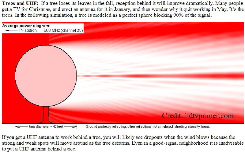

According to your report, probably not unless the trees are in the signal path; they also block TV signals. Try it without a preamp first. If one is needed, I suggest an Antennas Direct Juice preamp.
3: How high up do you think we need to mount the antenna?
Ideally, high enough to clear the trees. Your report doesn't state a height, so it is at the default height, which I think is 10 feet.
4: Any chance we'll be able to make attic-mount work, or will it need to go on the roof?
Outside is always better. No chance without the dormer, fiberglass skylight, or through the end like vinyl siding. The dormer is the best for inside.
5: Do trees have an impact on the signal we will receive? There are a good amount of oak trees around us.
Yes, they cause a lot of signal loss, especially when wet.
