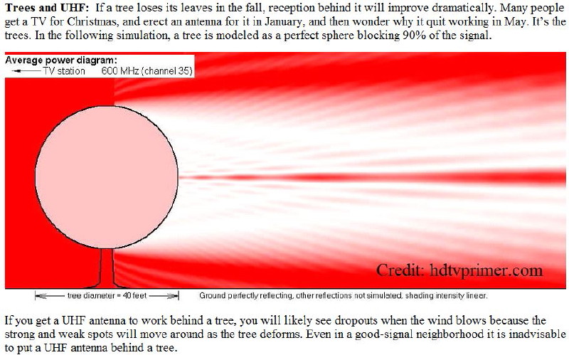

5: Do trees have an impact on the signal we will receive? There are a good amount of oak trees around us.
Yes, they cause a lot of signal loss, especially when wet.
http://forum.tvfool.com/attachment.p...1&d=1490730439
