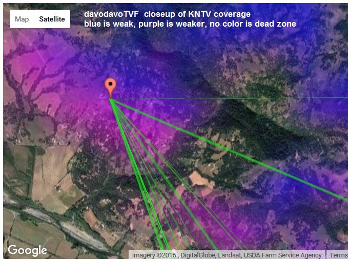

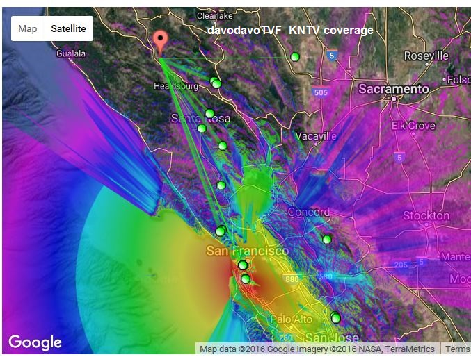

You are on the extreme fringe for KNTV. Small changes in location can make a big difference in signal strength. Don't be misled by the implied accuracy of the Longley-Rice coverage map; the computer simulation isn't any more accurate than about the length of a football field.

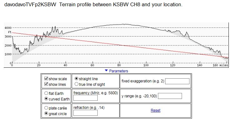

KSBW
http://www.rabbitears.info/market.ph...&callsign=ksbw
KSBW is 161 miles away in Salinas. The only way you can receive it is during a tropospheric propagation event.
