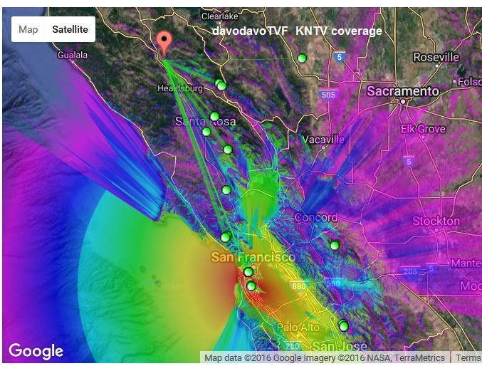

rabbit73 11-Dec-2016 9:10 PM
1 Attachment(s)
Originally Posted by davodavo (Post 56982)
I put in my street address, but something is messed with the altitude calculation because the results assume I can see through big hills that put me in the signal-shadows.
A terrain profile will show the direct path from the transmitting antenna, but some TV signals can make it to your antenna by atmospheric refraction which bends the signal down to your antenna and diffraction as it encounters the peak of a hill. VHF signals are more common in rough terrain because they can make it over terrain obstructions more easily than UHF signals. The tvfool simulation takes some of that into consideration, but its accuracy with 1Edge and 2Edge signals isn't as good as for LOS signals. The report assumes your antenna is outside and in the clear with no trees or buildings in the path.
Your report says your antenna is only 10 feet AGL; is that true?
If you click on a callsign in your report, you will see a terrain profile:

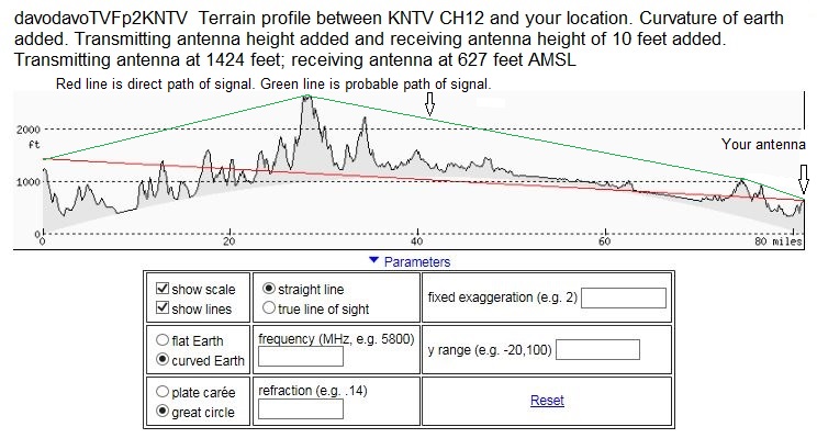

Here is a terrain profile for KNTV using different software. Note the curvature of the earth makes reception more difficult.
http://forum.tvfool.com/attachment.p...1&d=1481497837

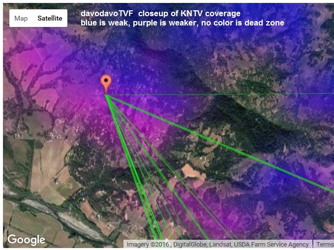

rabbit73 12-Dec-2016 1:46 AM
2 Attachment(s)
You are on the extreme fringe for KNTV. Small changes in location can make a big difference in signal strength. Don't be misled by the implied accuracy of the Longley-Rice coverage map; the computer simulation isn't any more accurate than about the length of a football field.
http://forum.tvfool.com/attachment.p...1&d=1481507046

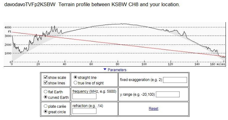

Some channels that I'm getting fairly consistently don't show up at all (most notably KTEH 54 and KSBW 8) on the list. These channels have been around for a long time, should be "right" in the database.
As near as I can tell, KTEH is the former callsign for KQEH, real channel 50, virtual channel 54.1.
http://www.rabbitears.info/market.ph...&callsign=kqeh
click on historical ownership
https://www.google.com/#q=kteh
KSBW
http://www.rabbitears.info/market.ph...&callsign=ksbw
KSBW is 161 miles away in Salinas. The only way you can receive it is during a tropospheric propagation event.
http://forum.tvfool.com/attachment.p...1&d=1481510331

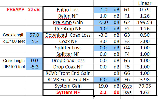

the fact is that your system. noise figure is set by the TV tuner which are ALOT higher than the routine 3 or so db that most preamps have
Not true. The system noise figure is set primarily by the preamp at the head end of the system.
The calculation of the System Noise Figure is done with the Friis Cascaded Noise Figure Formula.
https://en.wikipedia.org/wiki/Noise_figure
I use this calculator:
http://imageevent.com/holl_ands/files/ota
COMPARE System Noise Figures
With and Without Preamps
It's now listed as File Number 8, but might change if more files are added.

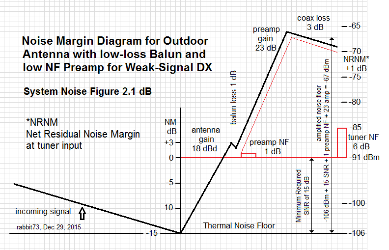

Here is the calculation I did for the Noise Margin diagram in post #6:
http://forum.tvfool.com/attachment.p...1&d=1486498685
The NF of the tuner doesn't matter as much when using a preamp because its noise is added AFTER the Noise Floor has been amplified, so it is buried in the amplified noise.
