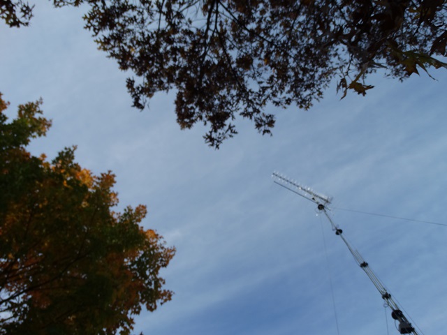

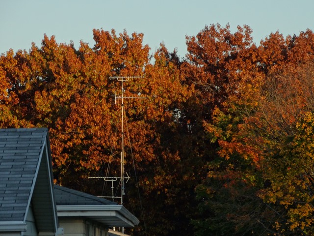

I know enough to be dangerous . The one thing that stands out to me is the tree issue. It may be that you cannot go high enough with a practical mast or tower.
Personally, I also have a black maple directly inline with my main mast, but built an unorthodox 10' tripod (think mini tower) with 35' of mast above it on top of my roof. 8 guy wires help support it. I was able to "shoot the gap" between the top of the maple and a an adjacent oak tree, it barely makes it.
From 400 feet away up my street (gradual upgrade) hill. It looks hopeless...
I have always tried to get a pic from behind the antenna but taking a pic at ground level doesn't show what the antenna "sees".
If you are behind a large maple what you get set up now may not work in spring. Being in Canada, I assume your maple has shed it's leaves by now. You may need a temporary set up for testing and have to revamp in the spring. My neighbor who is blocked by the trees in my yard uses a bay type antenna at about 15' AGL. His only hope was to get some wayward signals above/around my trees. He uses a CM 4228 HD. He has just enough signal strength to get most channels...And of course the CM 4228 really isn't a VHF antenna either, so for VHF you would need a MCM 30-2476 or 30-2475. Best antenna value out there in a day and age when most antenna companies have dropped their VHF only antennas:

Can you post a photo of your property showing your roof and trees?
File Type: jpg 2016-11-06 Antenna pics from distance 004 RS.jpg (169.7 KB, 1837 views)

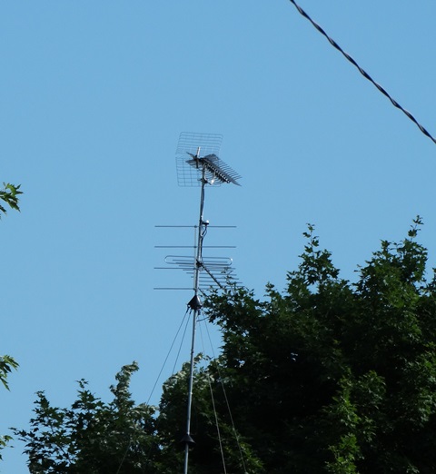

P.S. whatever antenna you buy an adjustable tipping type can point the antenna up (think less horizontal) to catch signals that may be coming from above. I tilt mine, luckily my antennas XG 91, 30-2476 (I have 2) and the HDB91X all have a tilt adjustment but I am not sure about the bay types.
No problem, I know a way to tip an antenna with no adjustment, my tiny avatar shows it (an accident that worked out).
