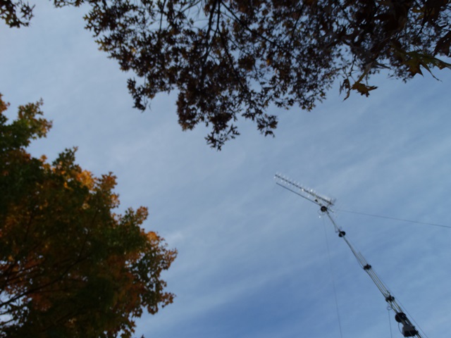

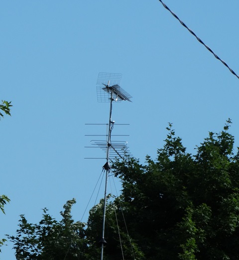

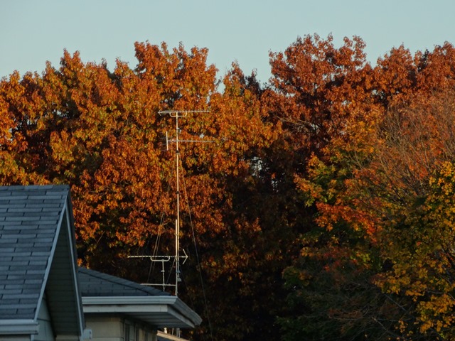

Personally, I also have a black maple directly inline with my main mast, but built an unorthodox 10' tripod (think mini tower) with 35' of mast above it on top of my roof. 8 guy wires help support it. I was able to "shoot the gap" between the top of the maple and a an adjacent oak tree, it barely makes it.
http://forum.tvfool.com/attachment.p...1&d=1480766885
From 400 feet away up my street (gradual upgrade) hill. It looks hopeless...
http://forum.tvfool.com/attachment.p...1&d=1480767079
I have always tried to get a pic from behind the antenna but taking a pic at ground level doesn't show what the antenna "sees".
http://forum.tvfool.com/attachment.p...1&d=1480767536
If you are behind a large maple what you get set up now may not work in spring. Being in Canada, I assume your maple has shed it's leaves by now. You may need a temporary set up for testing and have to revamp in the spring. My neighbor who is blocked by the trees in my yard uses a bay type antenna at about 15' AGL. His only hope was to get some wayward signals above/around my trees. He uses a CM 4228 HD. He has just enough signal strength to get most channels...And of course the CM 4228 really isn't a VHF antenna either, so for VHF you would need a MCM 30-2476 or 30-2475. Best antenna value out there in a day and age when most antenna companies have dropped their VHF only antennas:

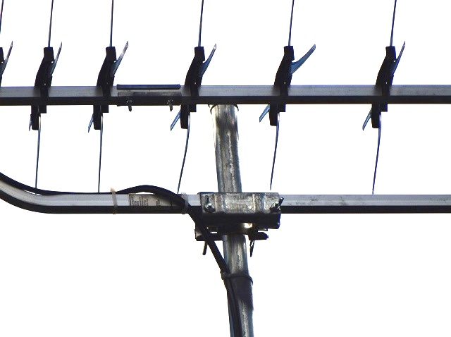

1 Attachment(s)
P.S. whatever antenna you buy an adjustable tipping type can point the antenna up (think less horizontal) to catch signals that may be coming from above. I tilt mine, luckily my antennas XG 91, 30-2476 (I have 2) and the HDB91X all have a tilt adjustment but I am not sure about the bay types.
http://forum.tvfool.com/attachment.p...1&d=1480769729
No problem, I know a way to tip an antenna with no adjustment, my tiny avatar shows it (an accident that worked out).
You may have to "walk the roof" with a signal meter to find the ideal spot, but when the maple come back in full leaf, you may have to start over!
I hope some other members can offer you advice, I can't say that I know what would work the first time. :)
